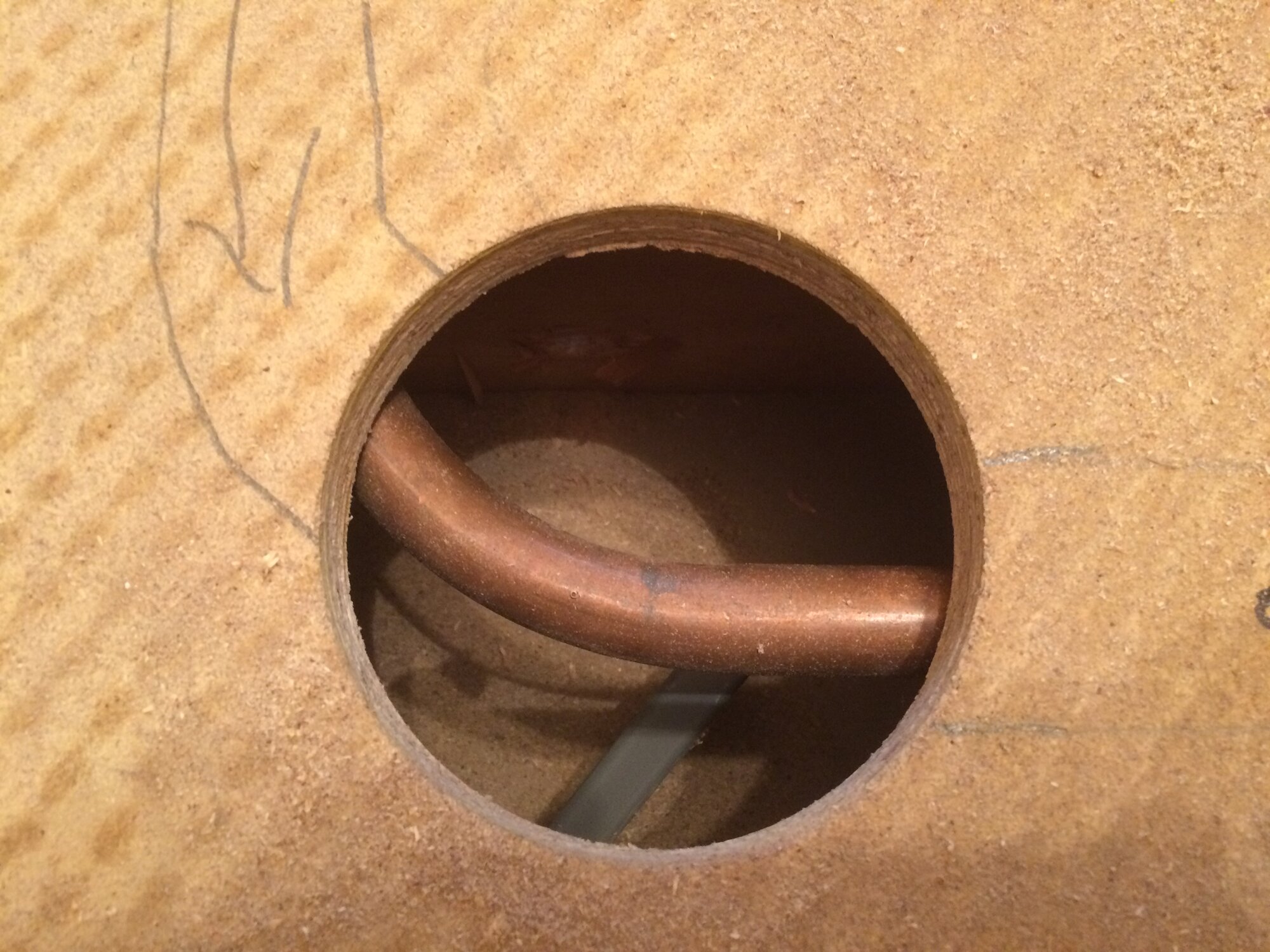

When I first returned to the industry a few years back, I cut a CH pipe with a circular saw. The pipe was not marked and flattened to go in gap between RSJ & under the chipboard flooring; water everywhere, before I could stop it. Insurance claim for decorating and carpet cleaning. Client even tried for a new 3 piece suite, but declined by loss adjuster. Three weeks later, client said his CH 3 way packed up, because of the leak. Insurance wouldn't add to the claim, so I had to pay for it.
All for a poxy new socket, I was installing for client.
After that, I became really nervous cutting into chipboard flooring
Four years later, this was my near miss with a gas pipe.
I was cutting the chipboard, with a 4" holesaw very carefully. Nothing to suggest the pipe was there (I put the markings on the flooring). Never touched the pipe. The Gods were looking down on me that day.

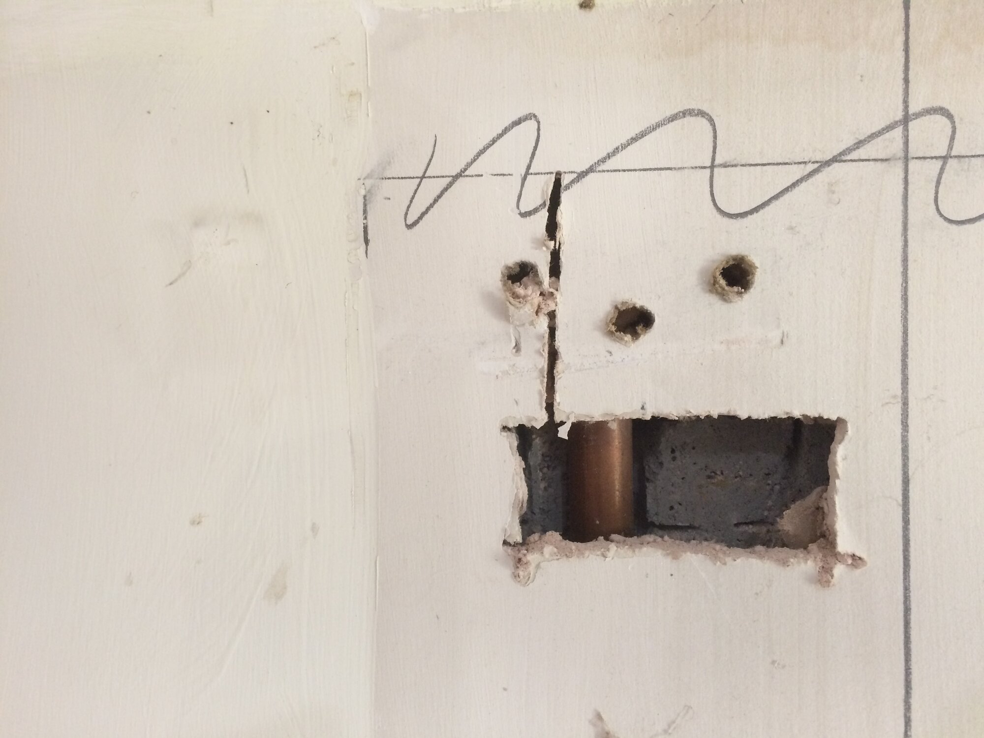

The same week, we found this when removing old units in a kitchen refurb. The screw just scratched the pipe.
