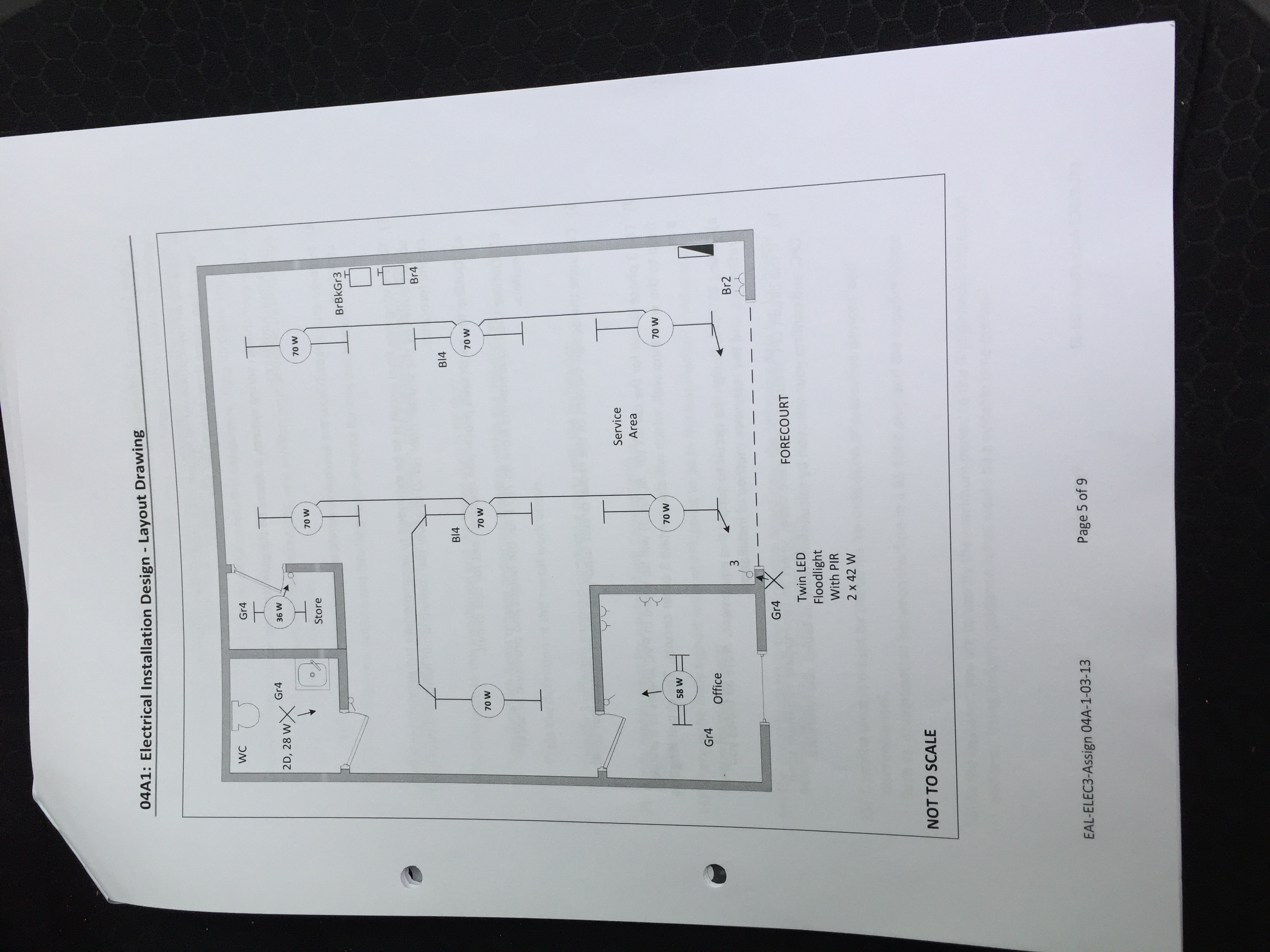

Do you know where get information for question 1 ,On suite guide or wiring regulation,I can"t see any information online .
question is State 5 sources of information which would help you design this installation .
Best have a stab yourself and post what you think, members will comment on your answer and provide guidance....but wont answer the question for you.
