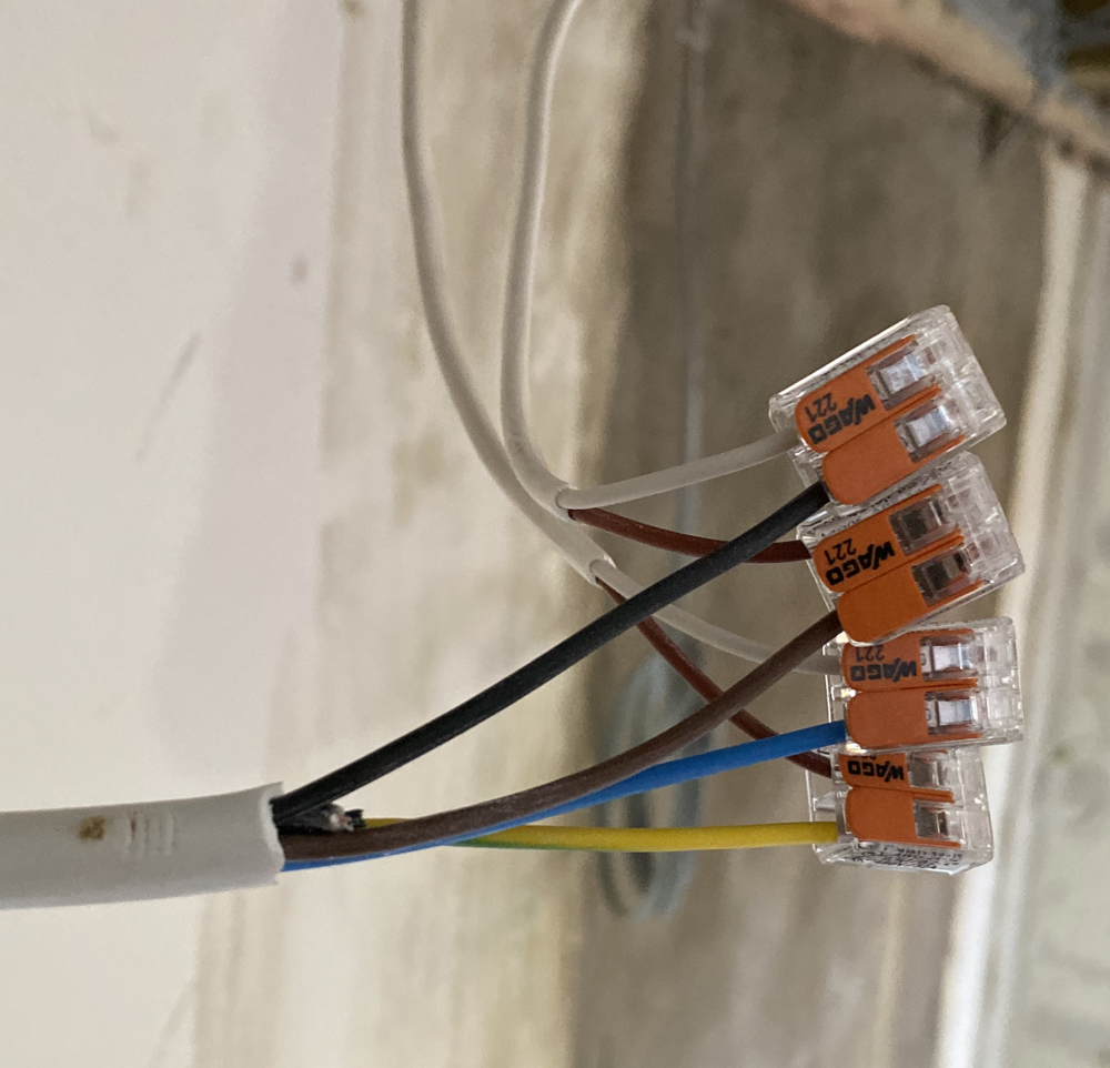

Doing a rewire of a kitchen where the exisiting electric windows are remaining
The previous controller/connections was cut out and thrown away with the builders demo!
Never really had to connect up a electric window before- I have extended the 2x 2core cables the go to the 2 windows- with a 5core into a cupboard that I can get power from via a 13a spur to fuse down...
But what gear do I need and what are the connections to power these windows again and control them
The client is happy with a standard switch- or the lighting is controlled by Lutron RA2- so if I could control it by this too that would be a nice touch
see photos of cables coming from 2x windows attached..

If you've not already done so, check if the actuators are 230V or 12/24V. Some models come in both a 230V and a lower voltage variant. You wouldn't want to get this wrong!

Im assuming they are 12/24v as the only cables that go up to the 2x windows are 2x 2core cables
so do i need to take a 6a 230v feed into a 230-12v transformer then the positive 12v into C of a 2way retractive switch then both of the reds into l1 and both of the whites in l2 but then how is the window actuator getting a N/negative 12v??

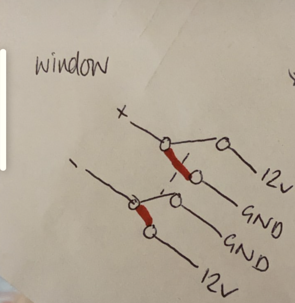

I do no have this- i just have a +&- from window 1 to a cupboard I have 230v in and same for a 2nd window
So after a 230v to 12v driver- i need a 3 position switch
(1)open circuit
(2)close circuit correct polarity (12v)
(3)close circuit reverse polarity(12v)

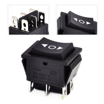

think I am just going to try the one i posted from eBay and try fit it in a euro module plate

you can get a12V 0n-off-on switch from a car accessory shop. may not be retractive though, so you'll need to physically return to centre off position.

The switch wont care what voltage is going through it the one linked uses the same switch module as the one you linked!
also your switch looks like it needs 3core going to window (O,C,N)
I know that's why I said to ignore the diagram and wire the connections to suit your wiring.
You need something like this however it is not clear what switch mode it is. You could try emailing them.
