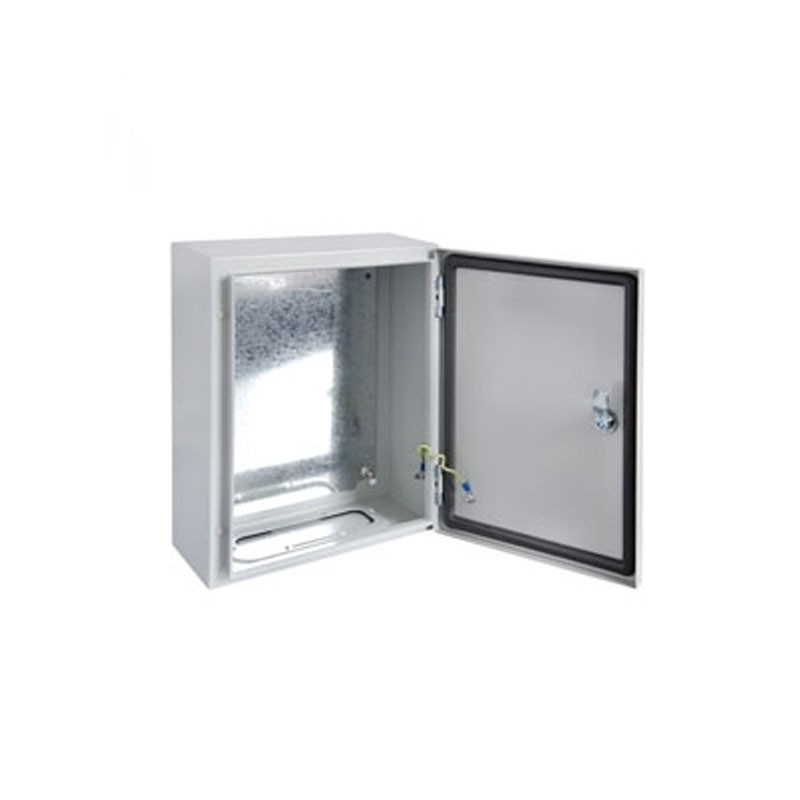

What about a suitably sized IP65 Metal Enclosure, something like this;
Bit more nicer looking, and hopefully keep the fat at bay. Lockable as well.
