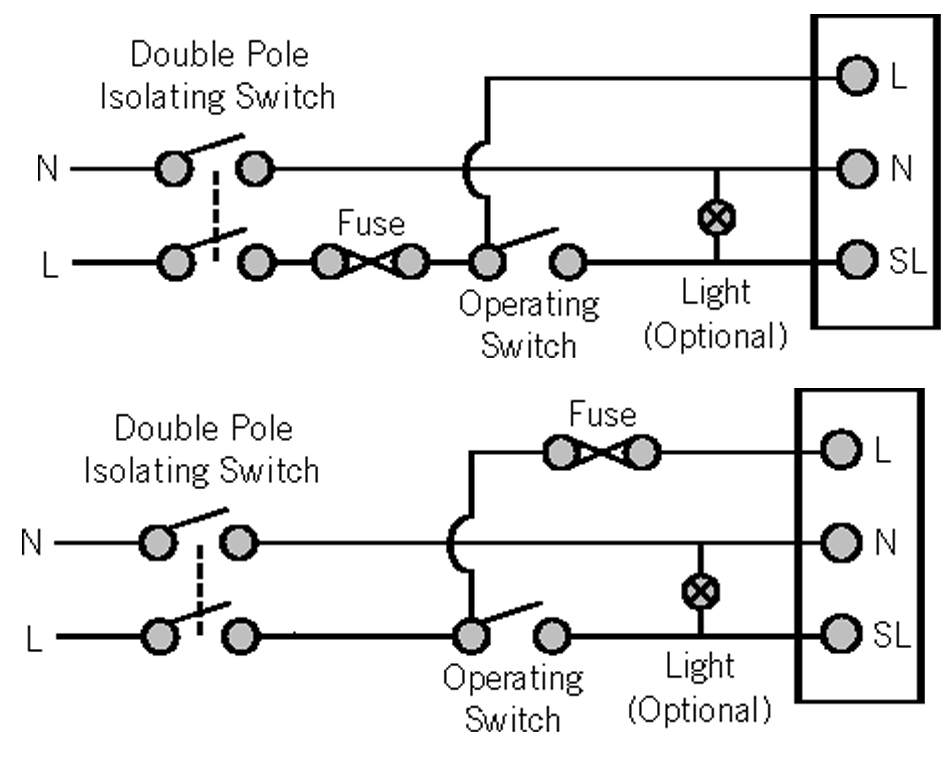

I think the two options are as shown in this borrowed and modified diagram and I would definitely prefer my fuses to isolate the whole supply and not just one leg of it.

with that diagram, you switch off the D/P isolator to work on/replace the fan, but you're working in the dark , as the light is fed through the isolator.
The way I am thinking is similar to the top diagram but with a triple pole isolator before the fan instead of the DP one at the start. OK, the lights will be off if the single fuse blows, but at least the homeowner will know something's up. But the fan can be isolated without isolating the lights as well.
The diagram was taken from a manufacturers leaflet and they do not require the triple pole isolator but they do require a DP isolator at "source", the TP isolator is a guide to the building regs recommendation so is not shown on the diagram. To comply with all suggestions there would also be a TP isolator on the three live conductors going into the fan.
If the customer allows me to that is how I wire extract fans: DPSFCU, Light switch, TP isolator, fan.
Amp Davids suggestion is also valid since the fuse is still before both line and permanent line, however you cannot have a timed overrun based on the light switch in that case. The only way to do that is to take the supply to the click unit from the light switch and this then means there is no local DP isolator, however the CU main switch would cover that (not what they intend but would meet the instructions and any way why does a light require a DP isolator so the 3P isolator for the fan could be considered over and above the manufacturers instructions).
