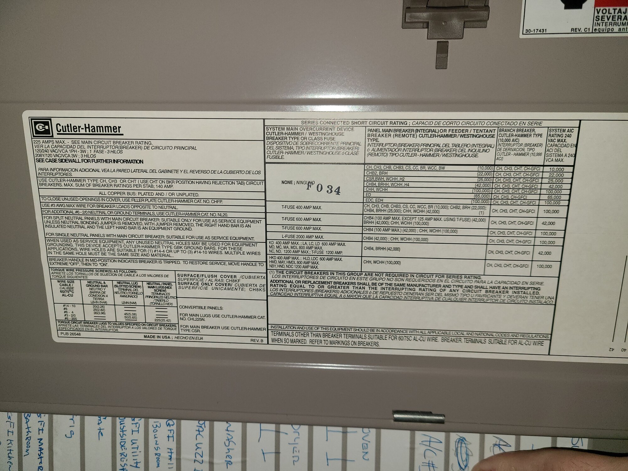

I do have one final question about getting a circuit in the box once I have an Interlock device. Our circuit box is full but has close to a dozen breakers for lights/switches. Can I switch several of those out for tandem breakers to make room for a generator breaker?

For a permanent arrangement?
Usually you would get an transfer switch to allow you to move the whole panel from utility power to a local generator, but you will need to shut down a lot of circuits as your generator is probably only 30A or so and not going to run lots of high current stuff.
Also you need to check if your generator provides a 120-0-120 supply so you can run both 240V stuff and 120V stuff safely (though I think in the USA 240V stuff is usually quite high power and might be too much for your generator).
Yeah, we can use an Interlock device to prevent backfeed but I'd turn all the other circuits off anyway. I was just thinking ahead for if/when I want to get it connected long term.
On the note of those breakers, is there any reason I can't convert some of those light switch ones to a tandem breaker?
