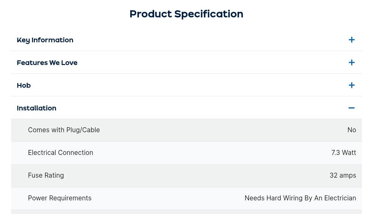

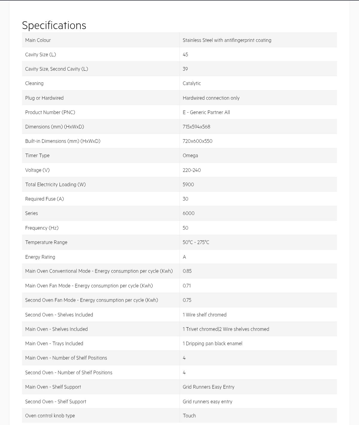

The AEG DOUBLE OVEN Model Number is DEU73111 HOB IS AEG IKB64401F-B

They certainly have NOT applied diversity, whatever their little report says.
Taking the diversity equation from earlier in this thread, (message #5)
For each appliance, work out total amps....
Hob
7300/230 = 32A
Take 10 off, and add 30% of remainder.... 30% of (32 - 10) = 6.6
Add the 10 back on... 16.6A
Oven
5300/230 = 23A
30% of (23-10) 3.9
Add the 10.... 13.9A
Total load with diversity is 16.6 + 13.9 = 30.5A
That's quite a conservative way of applying the diversity.
Taking the oven and hob as one 'cooker': 7300 + 5300 = 12600. Divide by 230 gives just under 55A
Take 10 off = 45A. 30% of 45A = 13.5A. Add the 10A back on gives a diversified total of 23.5A.
Either way you do the calculation, there's no reason why they both can't be connected to the existing supply.
Edit: Just read the specs, and it's 5900W for oven, not 5300W, so diversified load is just over 24A.
I took the diversity factor from #5, and from other threads about it, if its a combined load with 2 appliances, you take off 20A to begin with... ie 10A each.
What i didnt take into account was a possible socket on the cooker switch, which adds 5A to the final result.
Can we take care that we are replying to Snow White's enquiry from message #21, and not Santa's from the beginning.... different sizes of appliances.
It's Snow White that my post's aimed at.
