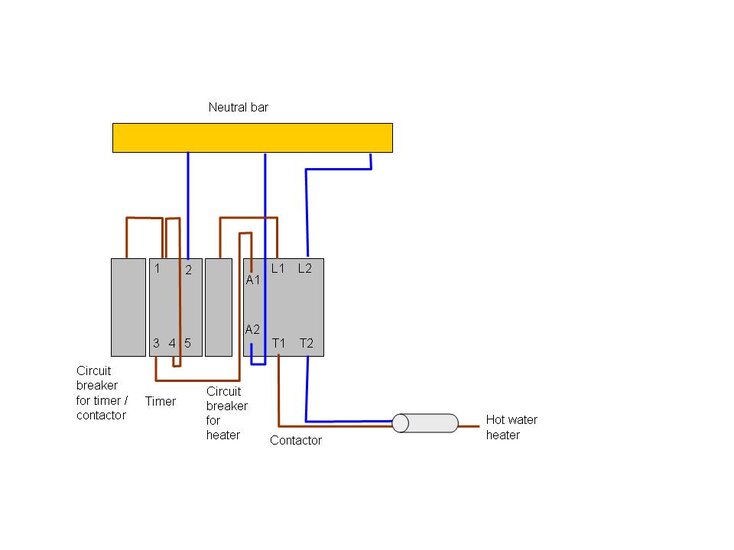

Hi Guys,
It's been a busy day and my brain has fried and died, so would appreciate any help that is given.
I am installing a Greenbrook T80-C timer protected by a dual pole 2amp mcb to power a dual pole 20amp mcb and a Hager ESC 225 contactor which will feed a 2.4kw hot water tank.
Can anyone please give me a wiring diagram.
Kind regards and thanks in advance.
Something like this?
Reactions: 5 people

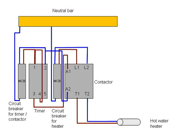

Not quite dual pole (DP) MCB's, but nothing to baffle our Victor, who basically just needed a kick start after a long day!! lol!!
Reactions: 1 person
Sorry:cry_smile:
Reactions: 1 person
I'm assuming E54 is referring to the fact(?) you need DP MCBs in France?
But in this case, would you? The circuit outwith of the DB is DP protected by the contactor(?).
Set me right Victor! :-)
Many thanks for taking the time to reply, you are a star.

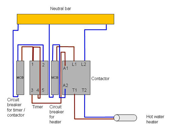

No problem, just a bit of a error on the MCB side, oh yes and my second picture was all wrong, got the protections mixed up, this is better!
Hope you managed to sort it OK. Despite my diagrams!:wink_smile:
Dual pole is normal here in France Archy, and yes both poles out of the contactor.
All Sorted and thanks Richard, the diagrams were great.
