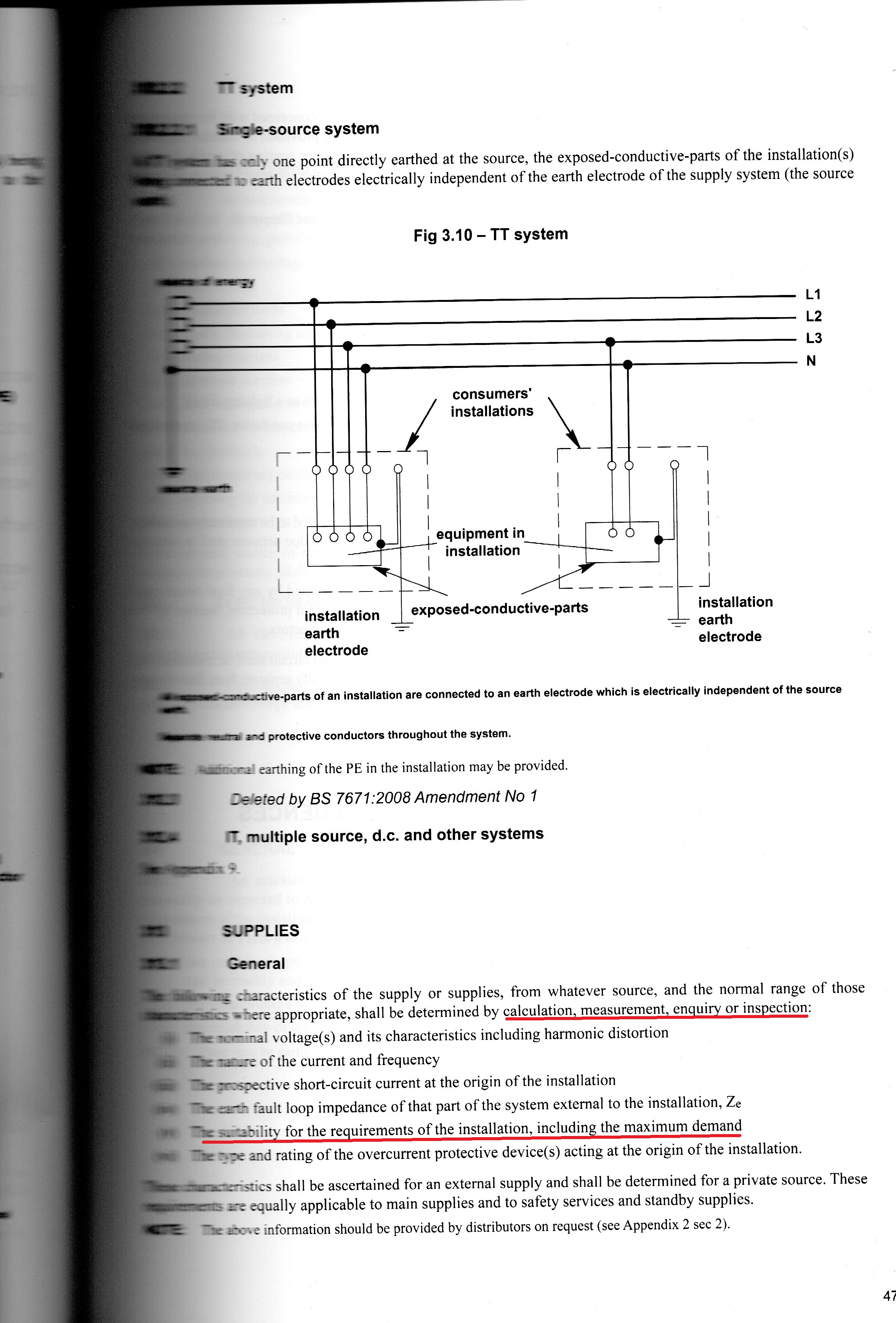

I thought the maximum demand was the maximum current your installation will draw. If your maximum demand is more than the suppliers main fuse you can use diversity to bring your maximum demand down.
If I am correct you cannot obtain your maximum demand by enquiry, because nobody else would know the details of the installation you just designed and installed and they do not know what appliances you have on your circuits, therefore you have to calculate the maximum demand of your installation.
But in BS7671, it does say you can obtain your maximum demand by enquiry. Please refer to attached document.
You can however obtain the prospective short circuit current at the origin by enquiry, you can phone your supplier and ask the value of Ze, then you can use the equation 230 / Ze to get the current. I = V/R
So my question is, do I have all the correct or is the maximum demand the maximum current I am allowed to draw i.e. the value of the main fuse?

Tbh I would have gone with C as well but seeing your whole post and thinking about it I would agree with your tutor. Because clearly it is not the OCPD or tails so there are only the two left. PFC is by measurement or calculation but not enquiry. Although saying that the DNO or energy will provide a notional max demand based on Kwh hours used in Kva. Given that you have been getting bills. This would not apply in a new build for instance. But then they do work on expected and usual demands at the design and supply level for new builds. So yes you could enquire, calculate or possibly measure when the installation is in use I suppose. Difficult one and it underlines the strange grammar and syntax of C&G question which are a notorious trap in exams.

BS7671 says you can obtain prospective short circuit current. You mentioned prospective fault current, that is not an option, only prospective short circuit current is an option. You could not obtain prospective fault current by enquiry because the supplier does not know the CSA of your CPC. The supplier does know, however Ze and the supply voltage, so they could provide you with the prospective short circuit current.

I think there is some confusion between maximum demand and maximum current carrying capacity.
The current carrying capacity is fixed by the physical characteristics of the circuit. The maximum demand is the use to which the circuit is put, and is variable. I think this is made clear by reference to Appendix A (maximum demand and dversity) in the OSG.
When designing a new circuit the only way to determine the max demand is by enquiry ie. ask the customer what it is to be used for, and then design the circuit accordingly.
With an existing circuit you can (1) ask the customer what is connected. Enquiry
(2) check the rating plates on the appliances and work it out. Calculate
Or (3) stick a Clamp Meter on. Measure
So the correct answer is A
