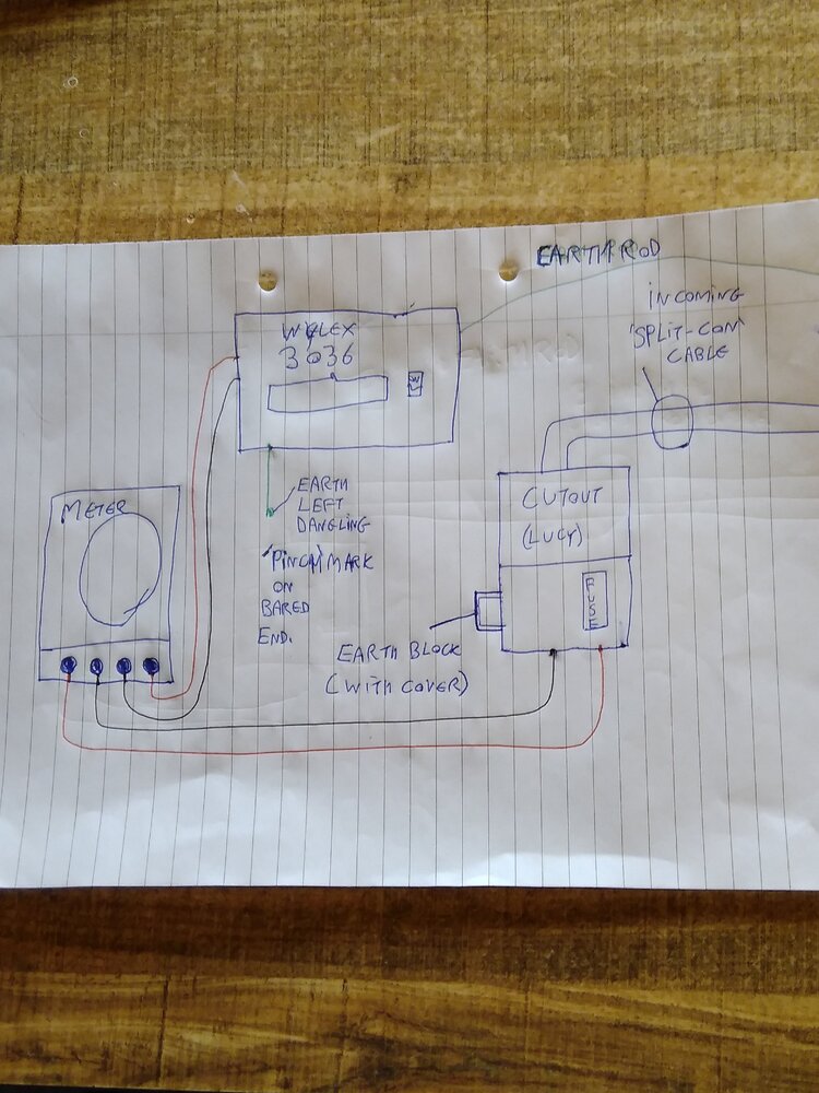

Good Evening
Although You you and pc1966 have been very helpful, which I am extremely grateful for, I have attached some drawn diagrams of how things have been over time.
(BTW, the current CU was installed more around 1996).
You can see the layout pre 1990, 1990-1996 (with no effective Earthing!!!) and the current layout.
My idea of what happened (however I cannot be totally sure) is when the house was initially rewired in the early 80s with the 3036 CU, is my father (although he didn't re-wire the actual house himself) installed a small (obviously ineffective, in dry rocky ground) *Earth rod outside, but unaware of an Earth *already provided from the overhead supply.
When the new cable and cutout was installed in 1990, and he mentioned to the DNO chap he had previously installed an Earth rod, he claimed the DNO chap suggested there was an Earth on the poles supplying the house, and with regard to been told this, probably *assumed the Earth was connected and in place (however, the Earth cable from the 3036 CU was left dangling, since if it was meant to be connected to the DNO Earth, it was too short to reach the new cutout (and of course the 'pinch' mark left in the bared end I tend to remember).
*my father, just like many others, is not very familiar with electrical circuitry, so I do not consider this as his fault in any way.
The Earth rod and cable in use is still the same, but the cable was relocated lower down when the new CU was installed.
Please see the diagrams for more information.
PS I have used the colours Red, Black and Green to denote Line, Neutral and Earth cables respectively.
Has a more effective local earth rod now been installed?
Unless you are getting a rod impedance reliably below 200 ohms (less is better, obviously) then you ought to peruse the DNO about the suitability of their earth and arrange for them to connect to it.
It is still the same Earth rod in place, although showing no signs of corrosion etc.
Perhaps I should not have stated 'obviously ineffective', however, although one cannot be sure without a Professional Loop Impedance instrument to measure the Ze and therefore give a specific numerical Ze value, the ground the rod is situated in is fairly dry, rocky and is nowhere near within the 'General Mass' of earth, in line with the transformer (which supplies the OH line) Earth rod.
If you walk from the back of the house up to the transformer supplying the OH LV supply, it is a steep-ish uphill route, and the land consists of many rocks within the ground etc, so a very rocky place.

You have no idea how lucky you are to have a TN-S supply (at least the option appears to be there), one where the 11kv is also run on two insulated wires. I can't say for sure, but I'd imagine this supply would eventually go to TN-C-S when the secondary is upgraded as is typical today.
of earth the house rod is situated in. Again, the driveway, land etc in between are very rocky and dry places.
On a side note, the Loop Value on a Kewtech 107 Socket Tester lit up as 'URGENT CHECK', i.e. over 93 Ohms as indicated in the Manufacturers Instructions (although I am aware personal opinions vary on such instruments).
The photos show plenty of vegetation around, so it is not as dry and rocky as some locations!
Still for a decent earth rod you probably need it to go down something like 2m or so. You can get 1m long SDS drill bits that would allow and easy-ish way to get down 1m depth and then see if you can drive a rod down further. Of course, you should always be aware of the possibility of hitting a pipe or buried cable (cable less likely I guess) and what some folks advise is to dig down 1m or so manually (e.g. fence post digging tool) as by that depth you ought to have found any utility pipes, etc.
Another option to get a better Earth is to make a deep but farily narrow hole (as deep as you can, basically) for the rod to be driven in then fill it with conductive concrete. That fills out in to the gaps and tends to retain moisture a bit better keeping the path to "true Earth" a bit better. You might find this cheaper elsewhere, but this is the idea:
Opinions on socket testers in these parts do vary, but the Kewtech Loopcheck 107 is actually a fairly good one. By "vary" I mean folk think they are pants, which is true if you compare it to a MFT operated by someone knowledgable, but as an affordable test for a DIY / home owner it s a damn sight better than nothing. The cheaper testers (£10 region) suffer from not detecting a high-Z earth, only one that is totally disconnected (above tens of kOhm in most cases).
So they won't detect some types of serious fault. Basically they prove bad, not good. If one tells you there is a problem then you need to do something about it, however if it says all is fine you could be fooled as it has not picked up on something like a high-R earth.
Also none of them pick out a N-E swap. If the socket is RCD protected that is quickly detected in use, but a lot of homes still lack RCD protection so not being able to show that fault is another grey area. Now usually the R1+R2 test with L-E shorted at the CU would reveal reversed polarity, but DIY socket change would not (and should not) be doing that, or a wander lead to check R2 would show it if mains was off (so N-E open at the house isolation switch), but again that is not a DIY/home owner sort of procedure.

Massive privilege. TT and TN-C-S are simply comprises (trade offs between various disadvantages/risks) in a world where utilities refuse to provide more than the bare minimum number of conductors that will light a light bulb or spin a motor. If I had to choose between IT, TT, TN-C-S and TN-S, I would hands down choose TN-S.
Low Z fault path, no stray voltage or current, no shock danger from a broken neutral (PEN), no danger from a failed RCD during an indirect contact fault, reduced line noise in old audio equipment... I'm forgetting about a half dozen other advantages.
Yes, certainly my view on the matter as well!
The TN-C-S option would not be so bad if it were a ring circuit (so no single PEN break causing 'earth' to rise up) but I don't think that is ever done (ring on HV yes).
In the United States we have it way worse, in that not only does our MEN serve as an LV PEN, but also as a PEN for the MV system. Stray voltage is a big problem especially on dairy farms, swimming pools, caravans and the like.
