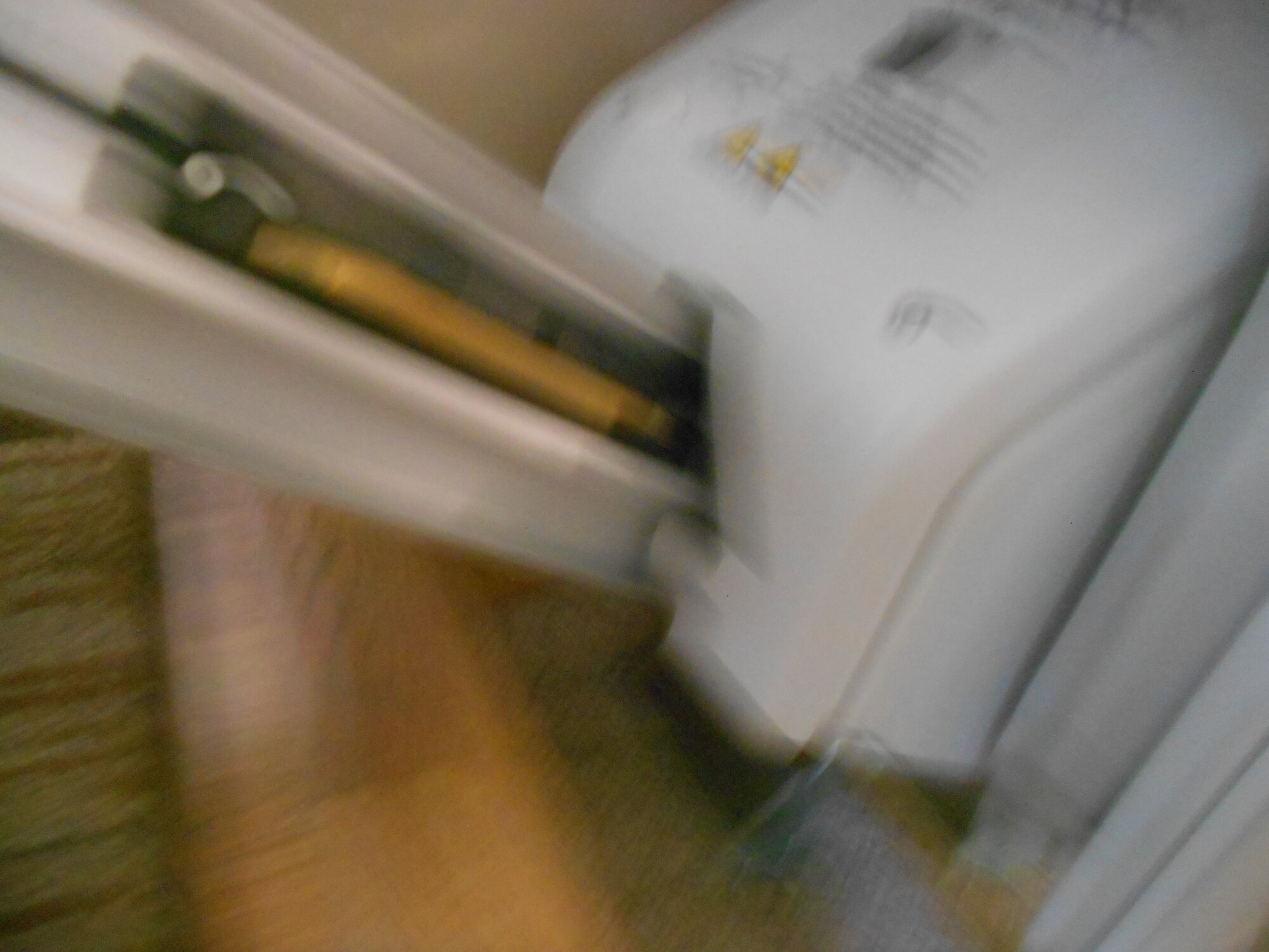

No, the charging contacts are at the top end and bottom end of the rail, there is no sliding contact. The chair operates down and up between contacts only by battery power. The warning does not read overcharge". it reads "overload". So, can I just continue to use the 29-volt charger, or could that ruin the two 12-volt batteries?

The copper strip is the charging contact point at the top end of the stair-lift, there is another one just like it at the bottom end. There are no sliding contacts on the rail itself.
