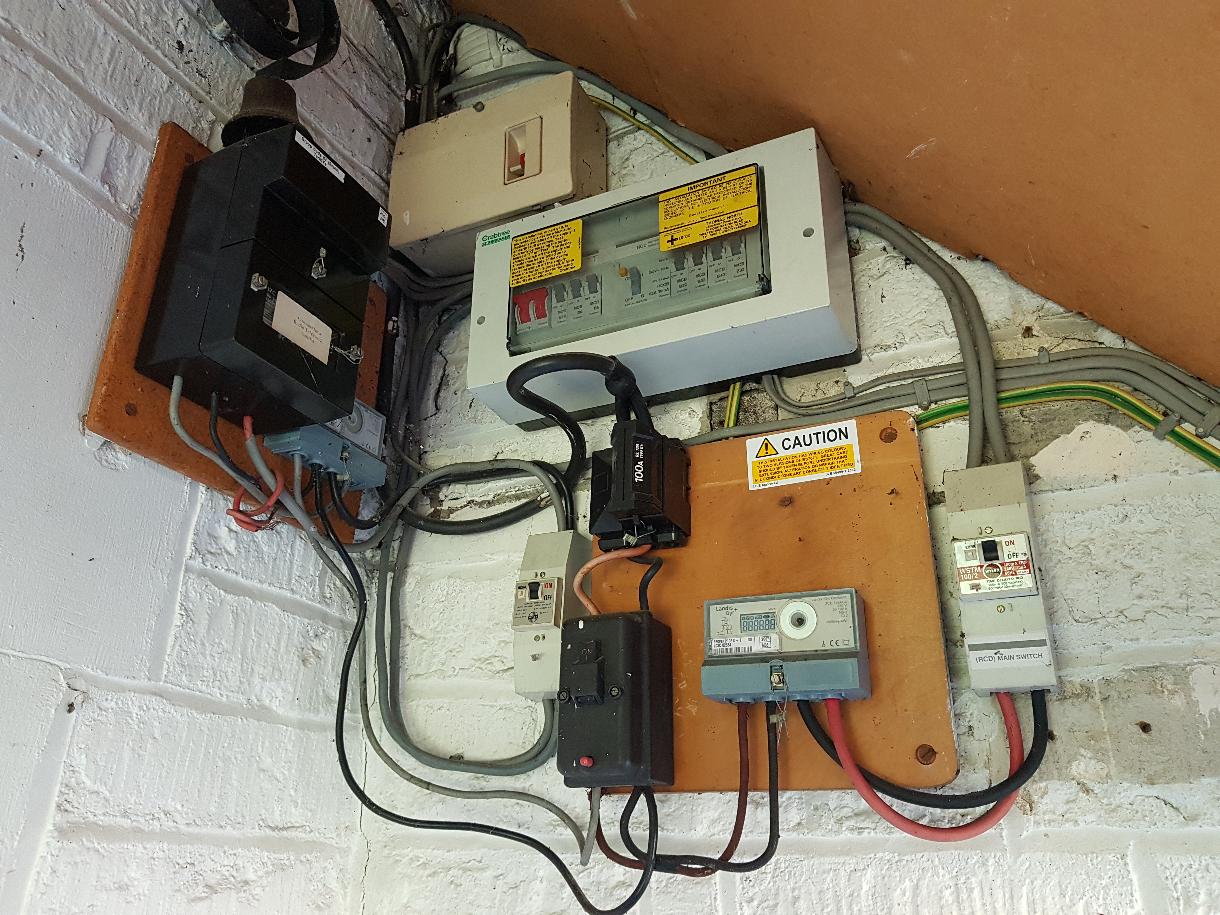

I am going to be changing this CU.
My question is who's responsibility is it to remove the old VOELB that is directly after the cutout but before both meters (see pic below). Im 90% sure it's the DNO? Is it just the meter itself that the supply company would be responsible for?
Will the DNO remove the VOELB and put new tails into the meter?
Thanks guys.

The dno stop at the cut out gear.
The utility company who own the meter will be the ones to connect to the meter but I doubt they will want to touch the voelcb as it’s part of the consumers installation
Strima
It's part of the supplier kit. Here's a pic of a diagram within the MOCOPA guide:
I'd request the customer contacts their supplier to get the VOELCB removed and their tails updated.

Thanks both. Looks like I got it wrong!
It can't be, as it's before the meters. But suppose the meters are the property of two different suppliers. Who would 'own' the VOELCB? Can one supplier even disconnect the feed to another's meter?

Never understood the problem that some electricians have ringing the DNO and why they prefer leaving it to the customer to talk to them. A quick phone call would have resolved the ownership issue even down to arranging a mutually convenient date to carry out the work if they are down to remove it
Leaving it to the non technical customer to explain the issue is just a disaster waiting to happen IMO

I will quite happliy speak to the DNO however when the customers supplier is involved they tend to want to speak to the account holder.

I think you make some good points and I expect i would have ended up dealing with the DNO, however this looks like it is the suppliers responsibility and I cant imagine them dealing with anyone but the customer?
