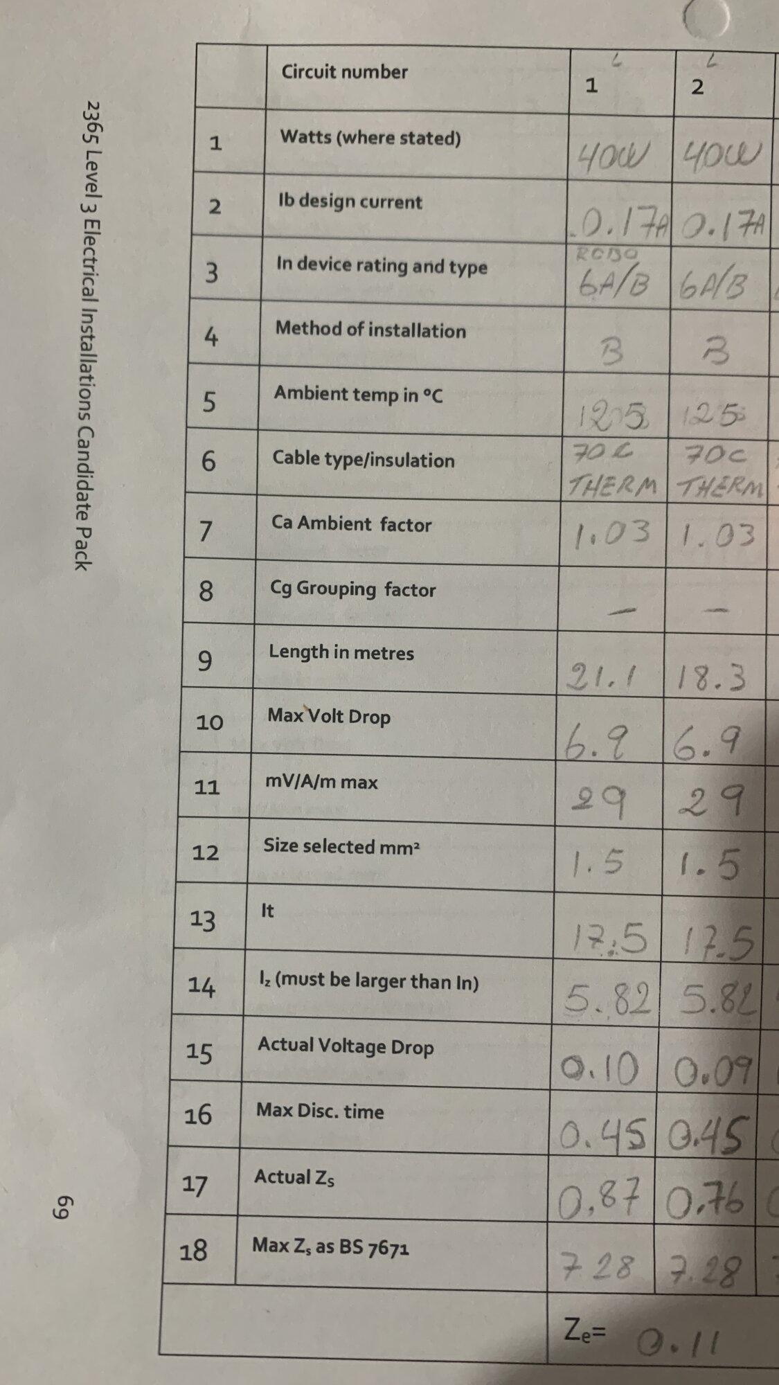

hi there everyone this is my first post here so be patience whit me.. Im doing the electric course and im doing my assessment and in need of some help.
for my understand iz=in/CaxCgxCi......
then it is from the tables 4D2A Correct?
on the images I add I did some of the calculations but I start to think im doing something wrong. can you clarify it for my.. like do I need to fill the iz when im doing a ring final?
Thanks for help...

Hi all, this is driving me mental, if I have a Ca of 1.03 (25degrees ambient) & a In of 6A or any number you like then Iz will never come out...
