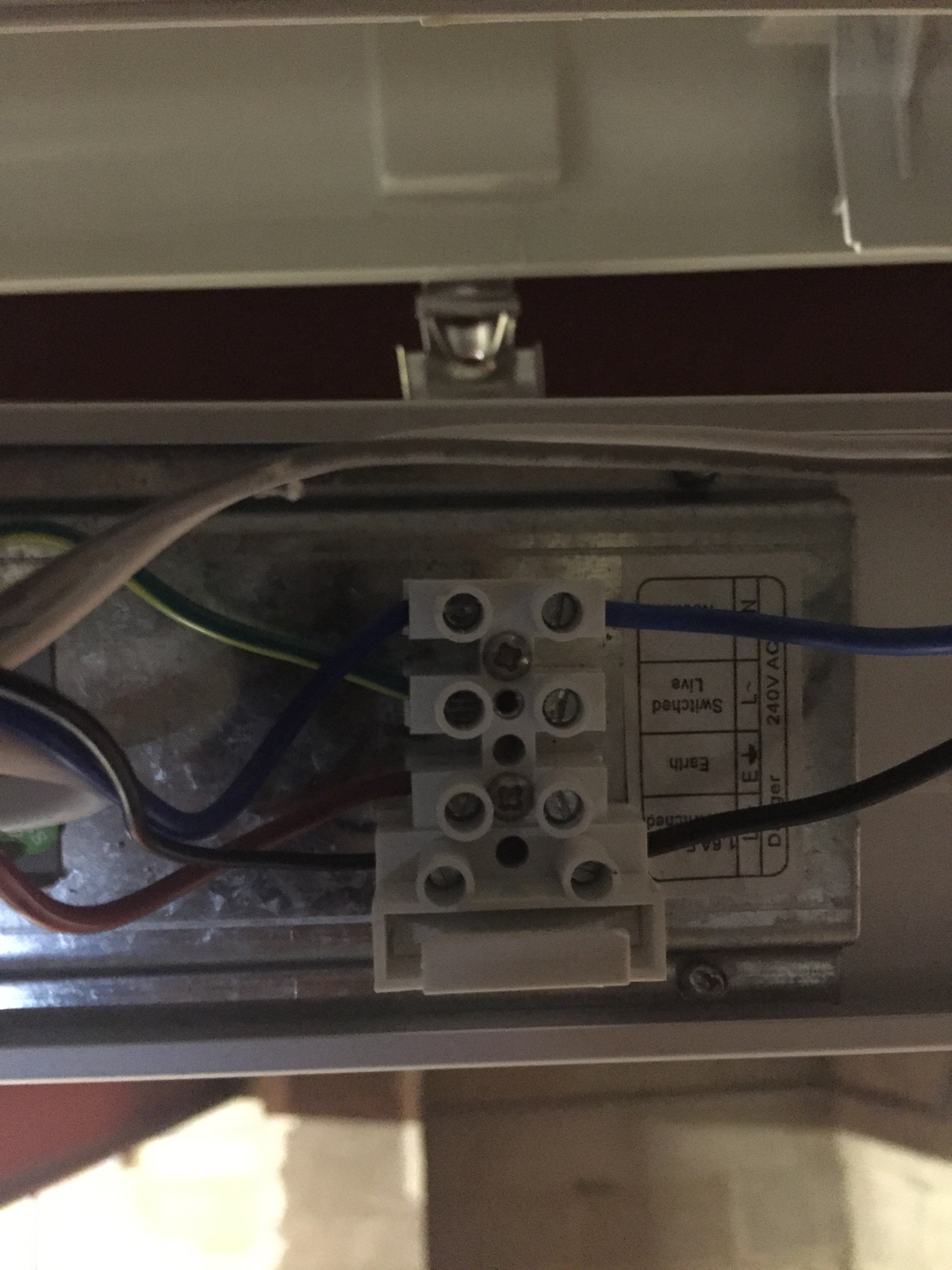

As the subject suggests JCC threw in a curveball in a 5ft LED light that completely stumped my apprentice.

1500 - comes up to me and says he can't do this anymore as he has a fault and 'checked everything' took the p*ss again.
He says to me the light keeps blowing a BS88 type fuse. To which I needed to hit the M25 before it gets stupidly busy and help him out. He is more than capable though!
So after using all the spare BS88 10A fuses he was going to 'try a 20A' to which I laughed at and said he's absolutely mad.
The light was fine before he put his up I kept saying so it has to be something to do with that. Asked him to pack up and I'll take a look. Saw the fault in a minute or so (attached) Took the p*ss again. And told him to put brown sleeving on the perm.

Right hand side.
Sorry the picture isn't the best nor my description
He obviously connected as per the instruction on the fitting. Not knowing that the earth terminal is screwed to the metal base
So if he wires to the label or the internal wiring, it's going to short.
What's that between the terminals on the connector labelled as switched live?
I don't understand the wiring on both sides look like the final connection and not the fittings wiring.
A bit tired here, so sorry if I've missed it, but isn't the brown in the earth connector, the 3rd one down on their diagram?
Is the one marked as earth actually the earth as it doesn't appear to connect to earth but the terminal the cpc is connected to does?
It looks like it earths the fitting with a screw through the connector block onto the metal plate in the fitting?
Looks like L into 3rd terminal makes fitting live but something else provided a path to ground before anyone touched it.
