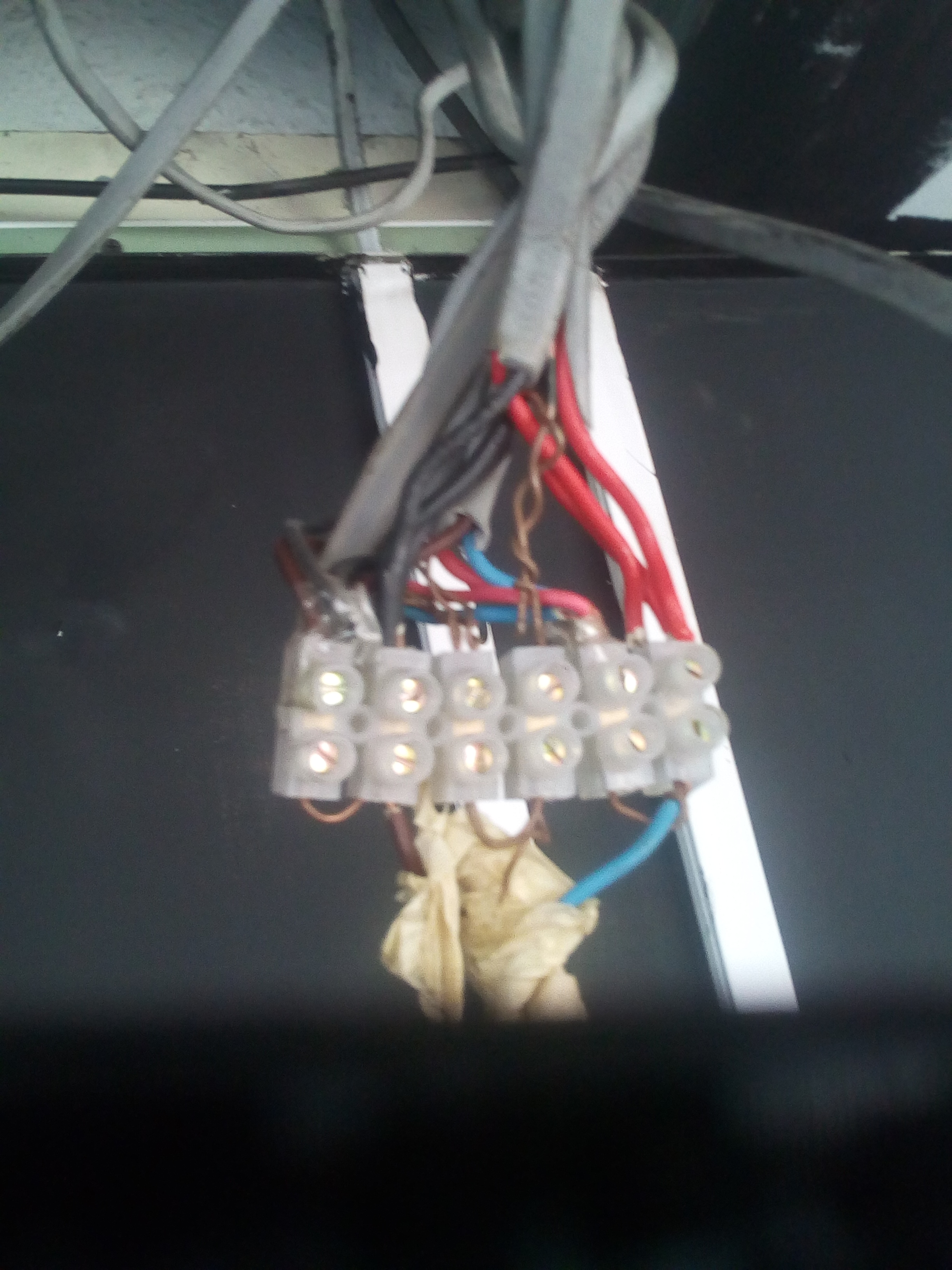

Very similar issue. Landlord speaks little English,,but tells me is electrician friend did some work a few months ago and since then the flat above has have lots of tripping.
So went back into the take away to look at this "electricians" work and found this
IMG_20170527_104904.jpg we could run a competition...see how many issues you can spot.
Lol. After yesterday's issues with a neon HT lead touching a ceiling grid I dropped everything before I looked inside the ceiling.
Did you spot.
No enclosure.
No earth sleving.
Bare copper wire used as links
L & N mixed
Masking tape used.
8 wires crammed in one hole.
Mixture of 2.5 & 1.5 on the same lighting circuit.

Missed the mixture of 2.5 & 1.5 on the lighting circuit :oops:
Issues with a Neon HT lead touching ceiling grid ? Now that's one I haven't come across Yet.
Photo says it all. I'm sure I'm not alone in saying I come across this sort of 'installation' week in week out. Worst one I ever came across was a shower cable that went from 6mm to 2.5mm then back to 6mm - all wired into 'choc bloc'... and buried in the ceiling void.
