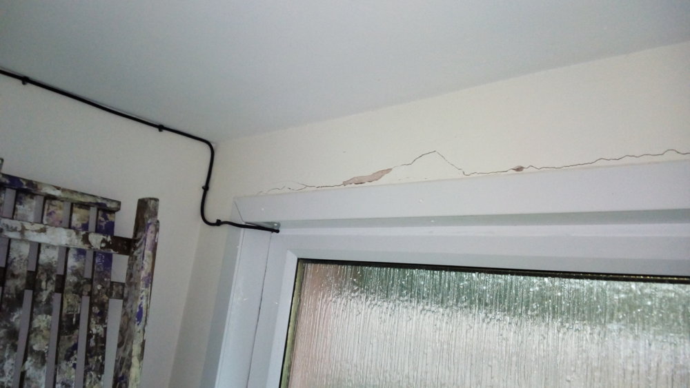

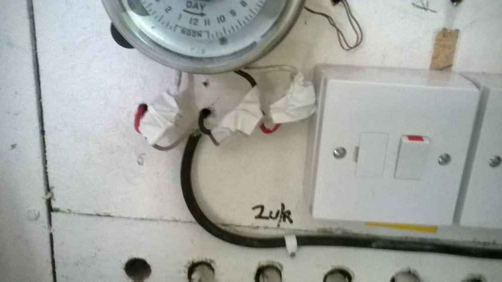

Here check these pics of our so called electricians work
If I had been there to supervise he would have gotten his arse kicked up the street until he was wearing it as a hat!
Spot the disasters:-
1) Used black cable cos it was all he had left in his van - no trunking or white cable to do the job properly And how did i know - cos he just chucked his empty reel into my plastics bin
2) Drilled through the double glazing and yip its now lost its vacuum seal
3) Checkout those leccie tails in the cupboard - not even recessed behind the backer board and not soldered or properly connected just scotblocked together i dont even think the tape is electrical - and the kid in our building puts his bike in that cupboard - those tails are live when the time clock switches on
4) Didnt even hoover up his drill mess

That is awful, leaving single Insulated cables wrapped in tape is breach EAWR.
The drilling through the window frame is just DS and something that I would expect a "sky engineer" to do. I take it this is someone the managing agents got in ?
If so report it to them with these pictures.
If he/she is registered with a Scheme you could also report it to them.
Is it the schemes fault though? They haven't seen or done the job.
Surely it's the customer who needs to realise it's terrible and then report it?
How do the schemes know?
(As a random bloke and not a sparky - I don't mean to be awkward when saying that, I'm genuinely asking - How do they know it's gone on? how can they react?)
and what are they going to do , they take the monies for the scam and they will tell the punter to get them back .
probably not alot but they are duty bound to sort it out. If the customer reports it to them, then someone gets a shock they would then hold some liability.
If it the schemes fault ?
Not really, but they are the ones whom seem to defining their members competency and offer some guarantee that their members comply with the EAWR, BS7671 and building control

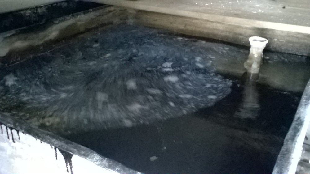

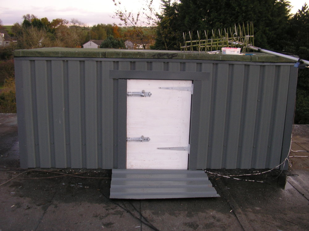

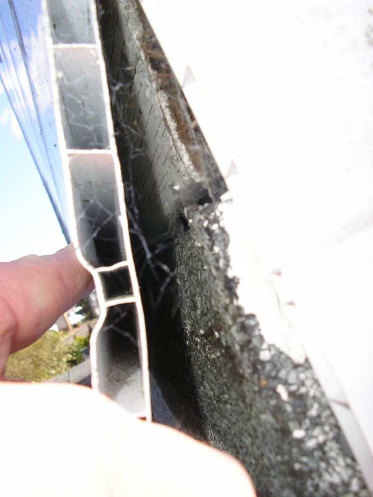

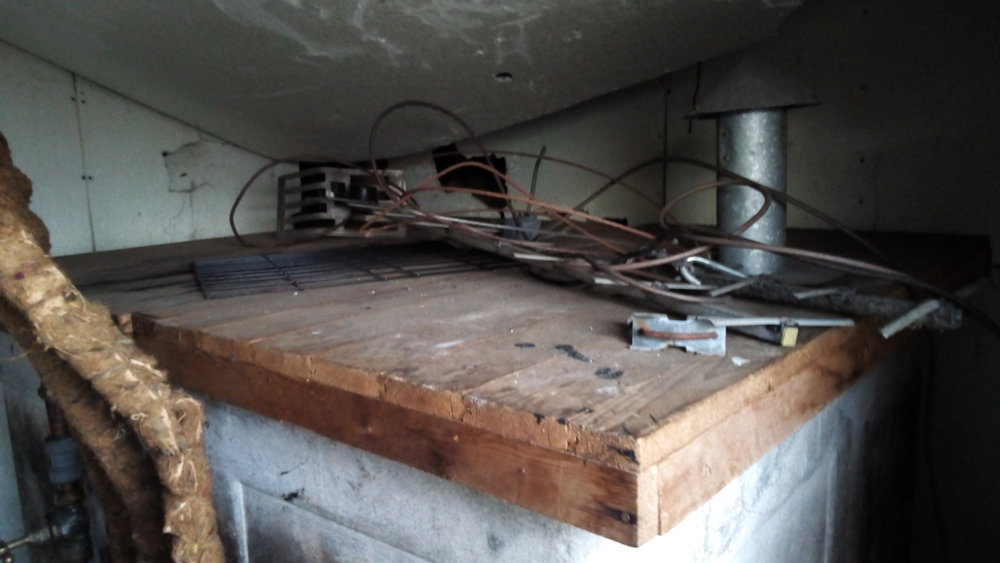

Want another laugh at some more bodge work
Check this water tank on the roof - plastic fitted over the old wooden housing and it has warped and will need done again.

When was that rooftop water tank last inspected / tested / cleaned?
Well i was up a few months ago i plan to do a drain and wetvac but I believe 1963.
The problem is the neighbours we dont get on and they are as tivght as a gnarts chuff so its hard to get any work done!
Here check the tanks - lovely - A good reason why you should never drink from the cold water taps in the bathroom lol

Thats the tankhouse on the other side - me and a good builder i iknow did our side and well what can i say - polish polish!

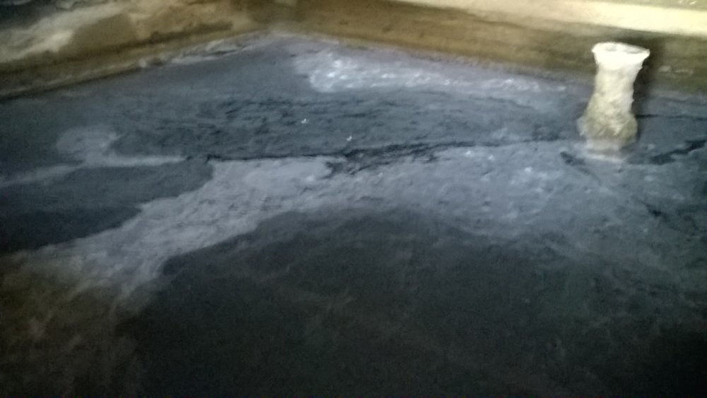

Please tell me that that tank is no longer in use.
Been in use since 1963.

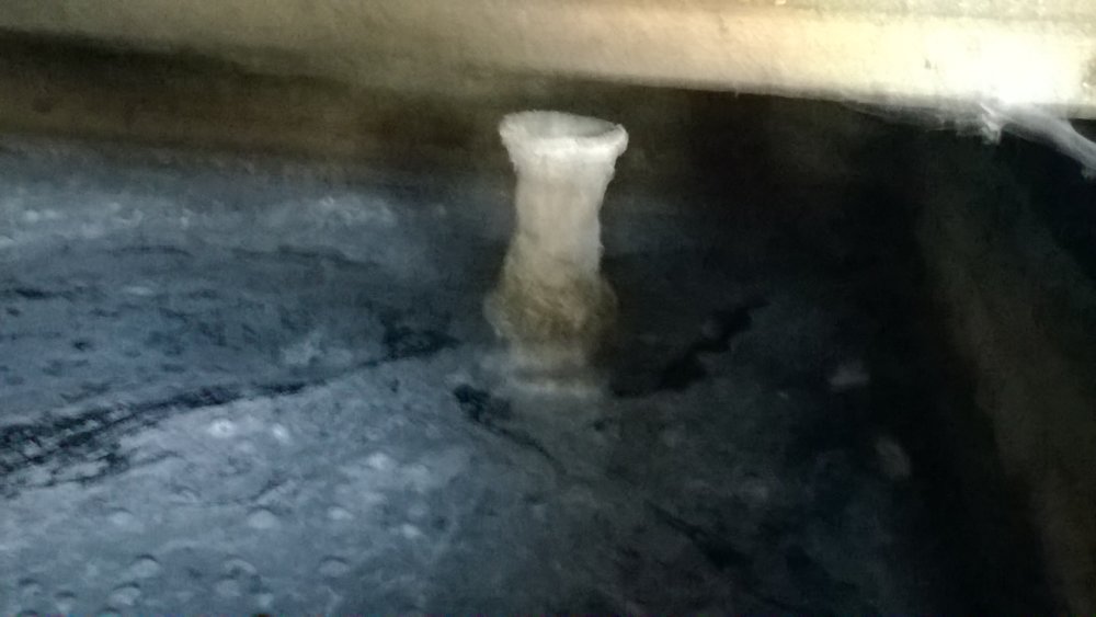

And yes that overflow pipe in the centre is covered in what looks like congealed fat and who knows what else and both tanks actualyl have an old wooden cover on em!
There also used to be a heater in that tankhouse peresumably to keep the water from freezing in winter but its burned out now in both tankhouses - health and safety in the 60's eh lol
We currently have issues with the cold water blocking - not flush in the cistern and cold taps not working - I have backflushed it every time there is a blockage but i need to get up there and empty them , wetvac and sort it out as there are two tanks - one on the left feeds the boilers and the one on the right feeds the cold water taps in the bathrooms for all the flats.
Pretty gross eh - not looking forward to putting my arm in either one!
