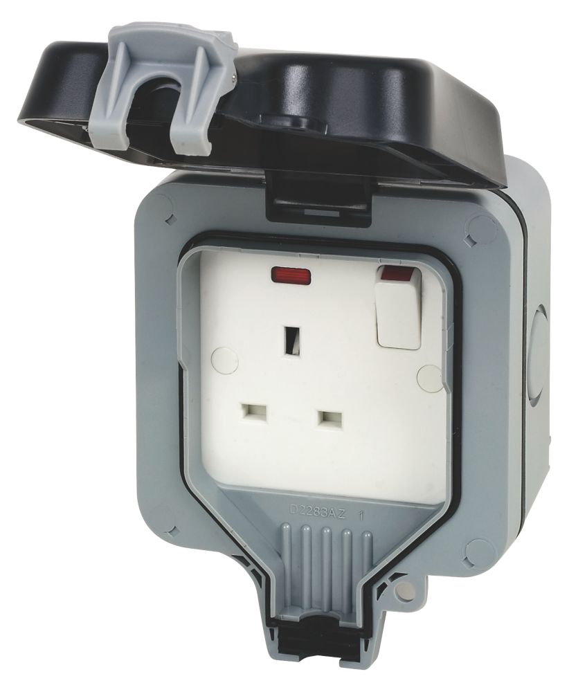

We are currently waiting for some work too be done on the incoming supply by the DNO so have had to purchase a ev granny cable to use for the next month, it will only need around four hours a few times a week.
Last year we had a new consumer unit fitted and a dedicated double socket fitted to the rear of the house for cutting the grass etc… this is on B16 RCBO
We need an extension lead for the granny cable to get from the rear of the house to the drive of around 20 meters, we looked at the following on screwfix
TIME 3183P BLACK 3-CORE 1.5MM² FLEXIBLE CABLE 25M DRUM (729JY)​
13A FUSED TOUGH PLUG BLACK (68744)​
And then some recommendation for a single waterproof socket?

You don't get any 13A sockets that are really, totally, all-orientation waterproof. This is the closest you will find and you would also need an IP68-style plastic cable gland for entry and sealing clamping:
They are not really suited to be used as a general-purpose trailing lead in the wet, they ought to be kept in a nominally upright orientation but you can probably make a small wooden support to allow that.
Thanks for the reply, I could strap the socket box to a fence to ensure it’s vertical and away from the ground.

It is not unusual to see 25m extension leads in 1.5mm cable, not an issue so long as properly made up.
