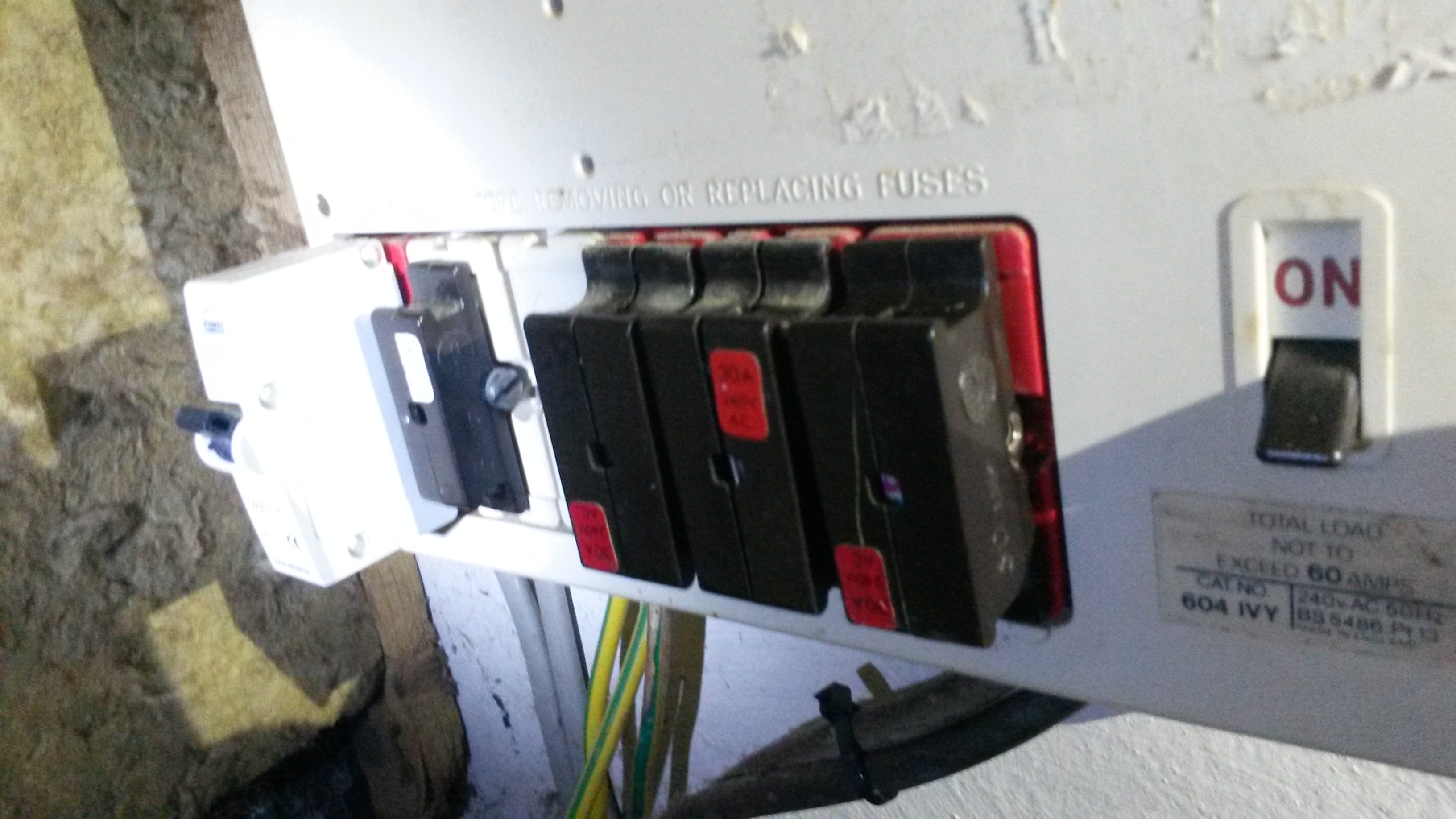

Hi all,
New here and looking for some advice please. I needed to fix a bulb socket in an upstairs bedroom, so I switched off all the electric at the fuse box and removed all fuses, I have 4 red slots and 2 white. There is only 5 fuses in total. So I proceed to fix the issue which just need to strip the wire back and reattach, all went well fuses back in everything on and all lights upstairs worked. Then tonight I noticed the downstairs main ceiling lights wouldn't switch on...so I looked at the fuse box and the only thing I could thing was the issue was maybe I'd put the 5 amp into the wrong white fuse slot. What I found is that doing so ment now I had the lights downstairs but lost the ones upstairs...I cannot for the life of me fathom this out myself. Any guide to a possible solution would be gratefully received please. Thank you in advance

OP Show us a Pic of the whole fusebox and then take out all your fuses and show us another one a bit closer in to all of the empty fuse holders and was there ever any ways without fuses in them what colour are all the dots on the fuses
Hi all, I shall get a picture and upload with responses asap. Tha know you for all your help. There does seem to be 2 5amp slots but I only have 1x 5 amp fuse...then 3x 30amp I think...which leaves me the fuse with the switch on.
look inside the fuse cover. see if the circuits are labelled.typically your 2 white spot fuses will be 1 for downstairs lights, and the other for upstairs. looks like you may have dropped a fuse for the dog to chew. check his basket/bed.

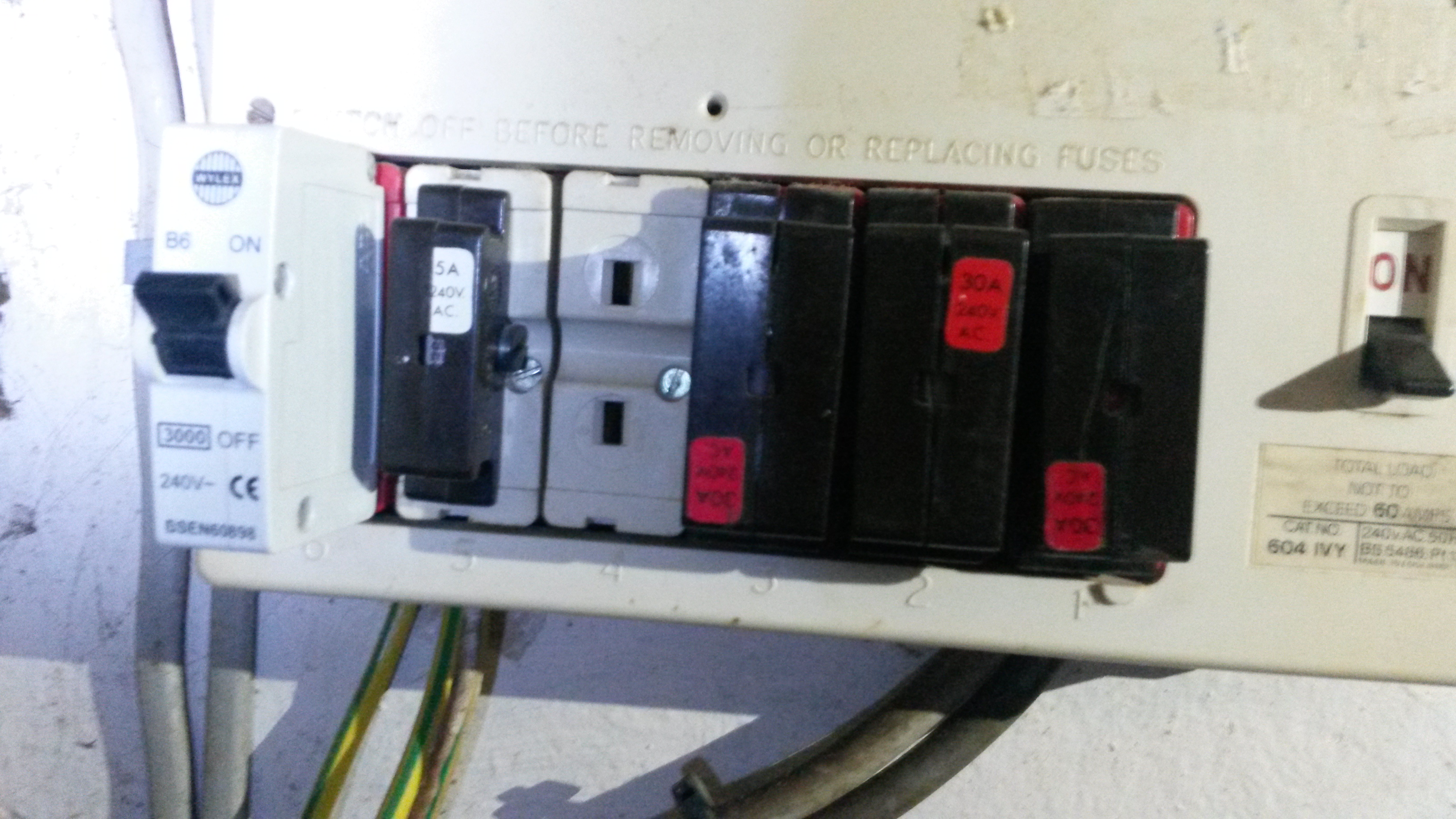

Here is my fuse box...With and without the fuses. Thank you x
The circuit breaker (the one with the switch) is 6A. That's for your lights.
So the 5A fuse and the 6A circuit breaker should be plugged into the two white slots.
It looks like the different breaker, the white one with wylex B6 ON written on in should be in the empty white slot.
As Sparkychick has just said, too slow I am.
Not sure what the empty red slot is for but possibly unconnected.
I thought the pins were sized accordingly to stop one accidentally putting the wrong one in the wrong slot, maybe that just covers sizing up so you do not accidentally or purposely try to up-rate the fuse rating, de-rating cannot cause any safety issues although nuisance tripping could be an issue.
I ain't falling for that one mark? they was all jumbled when I took them out in the first place anyway...I did actually set them all the same way but where I took them all back out and was getting fed up I couldn't be bothered with perfection for the sake of a sticker. The weird thing is I could have sworn I'd taken the switched fuse out the red slot and I'd laid them down in the order they came out...can't believe I didn't even think to moved it up
