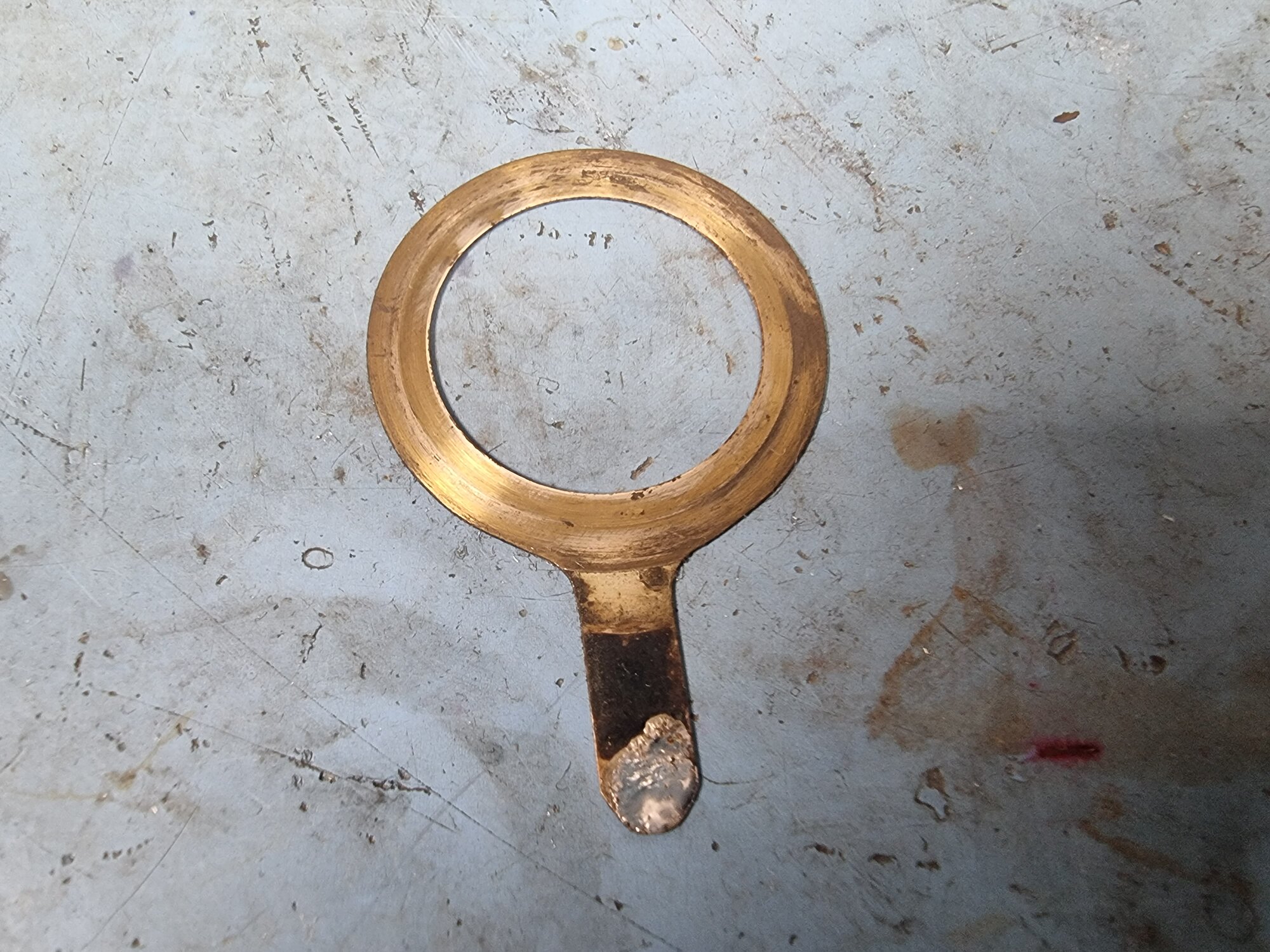

Damp here this morning, and the insulation resistance on a piece of workshop equipment seemed a bit low. I could influence the reading by pressing my hands against the outside of one of its controls. That, and the fact it is getting a bit stiff to operate, show that it's time for this control to be stripped down and cleaned. Metal deposits and dirt build up inside over the years and cause leakage.
The main core of the thing consists of 36 parts threaded onto a shaft. I slide them onto a long screwdriver to preserve their order and orientation as I take them off. Then as I clean each one I put it back onto the shaft.

Definite similarities though. That pic shows some of the conductive build-up on a moving part. It rotates around this part:

Nine sliprings, if you want to call them that.

So transferring power to a rotating part. Nine rings to cope with the amount of current needed to be transferred?
Nine because there are nine separately movable subassemblies. Hub, fixed contact (slipring), rotor and moving contact.

Operated manually. Nine 1-pole 10-way switches in a matrix. Dial each of the nine wheels to a setting from 0-9.
