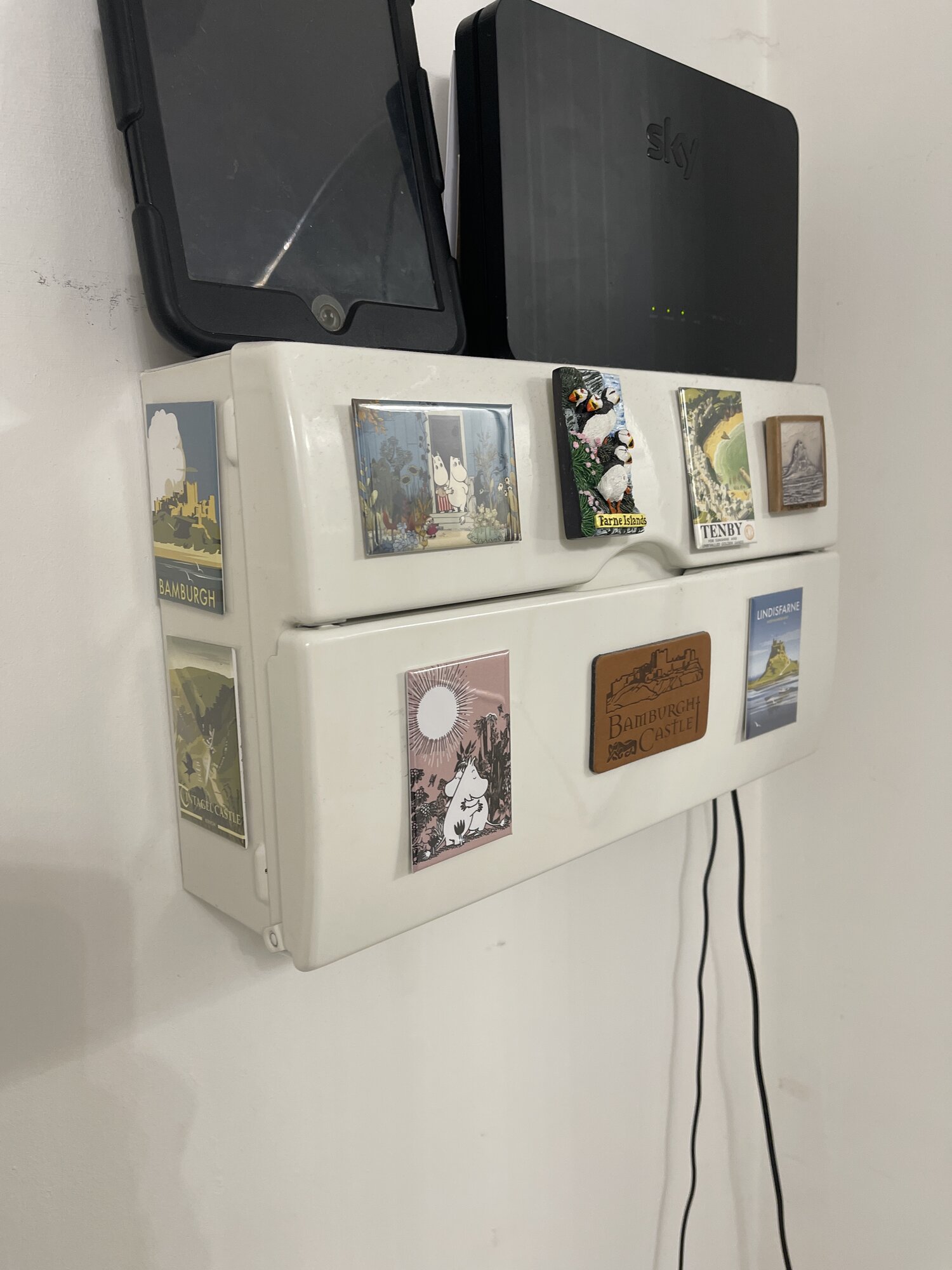

I know some boards use magnets to help the cover stay up and I’ve never been too bothered myself, my fuse board for reference ?

A fixed magnet can’t create eddy currents.
therefore anyone who uses it as an argument against allowing magnets to be attached to a consumer unit should be swiftly shot , removed from the conversation.

I see no real problem.
I have heard in the past of issues with them on PC cases next to the HDD or close to CRT monitor, but they are far more sensitive to any sort of disturbance, though for most jobs now it is SSD & LCD and so no longer an issue.
I guess fundamentally I don't like to see folk putting stuff on equipment so access is restricted, or kids encouraged to play with it, but realistically that is not something that is a real problem unless it is liquids (especially flammable) stored on top.
I hope people aren't storing their panic bought petrol on top of their CUs!
