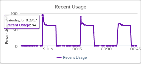

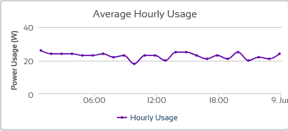

1717890430009.png This is the power used by my chest freezer, on average 1717890548934.png so even a 1 amp fuse should be OK, but you can see the start amps, and one has to question what the peak really is, and not all freezers are the same, my upright freezers with inverter drives have no where near that start amps, and since you say drip tray I would assume auto defrost, and upright and my upright highest load is the auto de-frost element at around 160 watt.

View attachment 116822 This is the power used by my chest freezer, on average View attachment 116823 so even a 1 amp fuse should be OK, but you can see the start amps, and one has to question what the peak really is, and not all freezers are the same, my upright freezers with inverter drives have no where near that start amps, and since you say drip tray I would assume auto defrost, and upright and my upright highest load is the auto de-frost element at around 160 watt.

Hah, i wish we could. But after lockdown we started a dog daycare business which means at any one time we can have upto 10 dogs running around. A cat might not enjoy that environment! Fwiw, i think the last count was 32 mouse traps in and around our property. Sadly we just have to accept that we live in a wooden shed in the middle of a large field. A necessary evil in my book.
Im intrigued with your monitoring software though, what is that?
