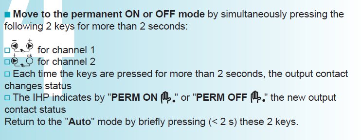

Gents I have this time clock, does anyone know how to overide the programme so it is permanently on, I cannot find the instruction leaflet and the new Schneider instructions make no sense.
Many thanks.
