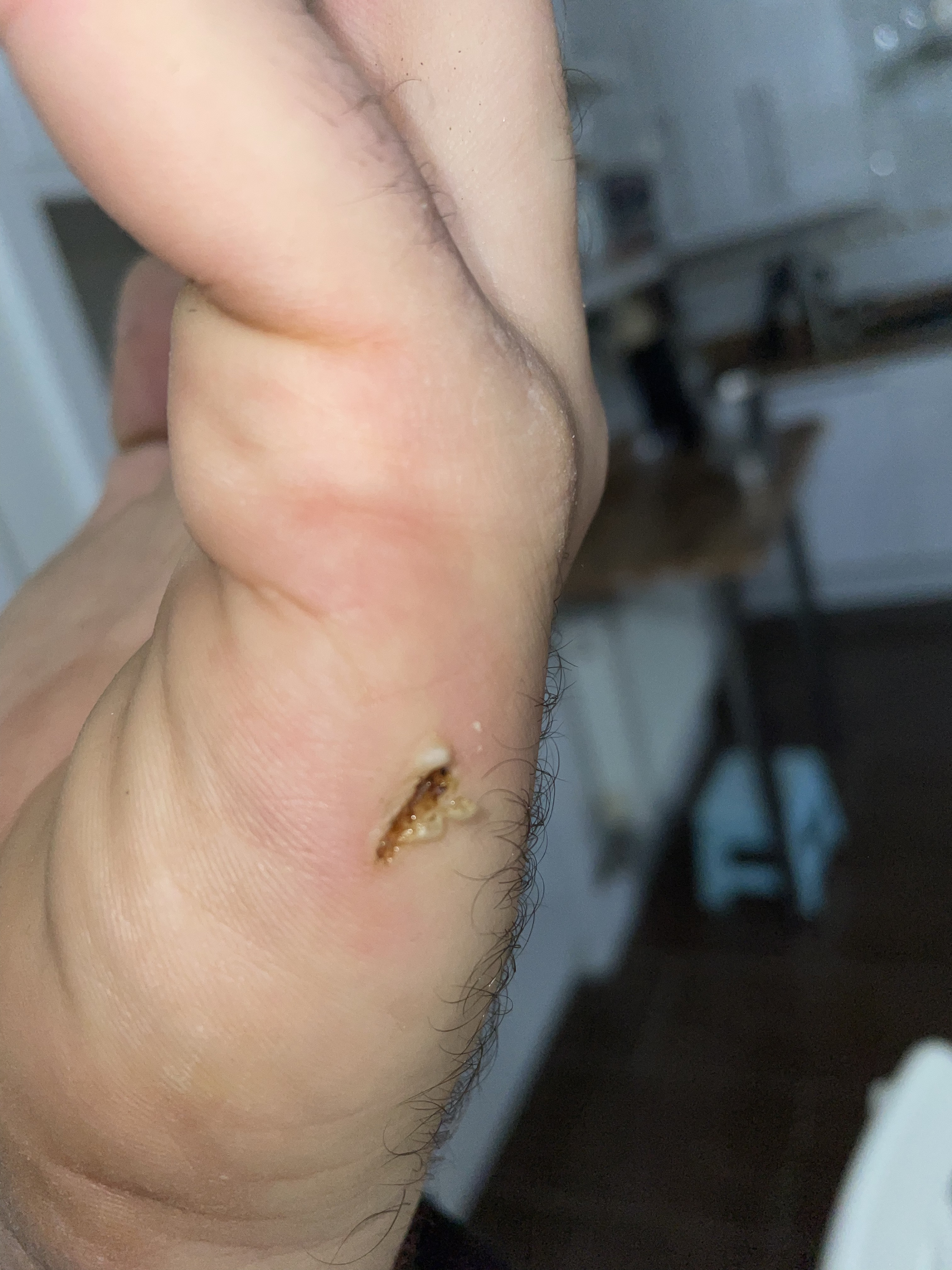

Here is a picture of the consumer unit. First MCB was the culprit.
There is the original RCD sitting on top of the consumer unit, I wonder why it’s been taken out!
Also added a photo of the damage to my hand from the live conductor.

Back on the job this morning.

I bet that hurts. Thanks for telling your story - it's a good reminder for people to never be complacent, which we all can be.
