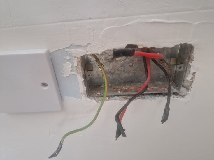

So it looks like diy Dave has disconnected the socket to fit in his badly installed stove.
Yes very likely a ring, but was just giving options.
If that’s how the cables were left, then you’ve technically got 2 x radials… the ends of both stopping here. If it’s still the original 32A breaker or 30 fuse, then it has been a potential danger all this time.
Those taped up ends are very likely to be live. Please be careful, and turn off the power if its being worked on.
It really needs to be made safe though.
