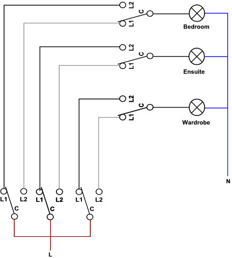

I have a simple job to wire a 4 bed house , however i cant get my head around the cheapest way to sort out a problem the customer has posed for me.
here goes
Master bedroom has centre light and 2 wall lights both on separate switches , then the en-suite has a walk-in wardrobe which had 3 led down lighters and en-suite had 4 led lights both on separate switches. all that is fine to me .
the customer wants a switch by the bed to basically turn off all of those lights at once when she is in bed.
and then the next day just switch lights on as usual .
there is no point taking the feed via that switch because they would have to turn that switch back on in order for lights to work.
i can definitely do this using a loxone mini server but wondered if there is a cheaper obvious was I'm missing , as hotels normally have this system in place
