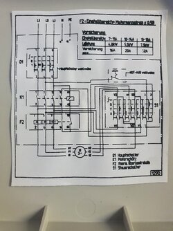

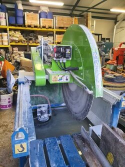

Yes. The machine has only been used once since new, albeit about two years old. The first and last time it was used was about a year ago after which it was turned off and parked up. The star/delta is a mechanical switch which the operator operates, the top switch in the box, as shown. I left it running for two seconds in delta, and started to smell something, so quickly onto delta. We disconnected the drive belts and the motor on its own spins ok. The point being that the blade is quite free running on its axis. A few times we have spun the blade by hand before switching into star, and even though the starting torque required is obviously considerably less, still the saw wont run. It tries for a split second and then trips out. I have tried adjusting the current reading on the relay, but not really sure what that does? I should add that my days as an electrical engineer in telephone exchanges finished 50 years ago, so am a bit rusty on all this.Has it previously worked normally?
Can you post a picture of the end showing the switches?
Normally there's a timer which automatically changes from start to delta, are there any instructions as to how long to leave it running before switching over?
When it cuts out what do you do to get it running again?
I wouldn't know exactly how to test the star/delta transformation with my meter, to see if its effective and working. Since it is a mechanical change-over switch, and only been used once, I would assume this is ok. This is a wet-cutting saw, with an electric pump re-cirulating water onto the blade, from the water reservoir beneath the blade. I will take a small video, and try and post this. One thing for sure nothing is seized up, or difficult to spin.You might want to disconnect completely the motor during your starter investigation because at this stage it is not required in circuit and will be safer (and quieter). Always pause a few minutes before re-applying power or starting machinery to work through in your mind if you and others are safe and the machinery will not be damaged.
