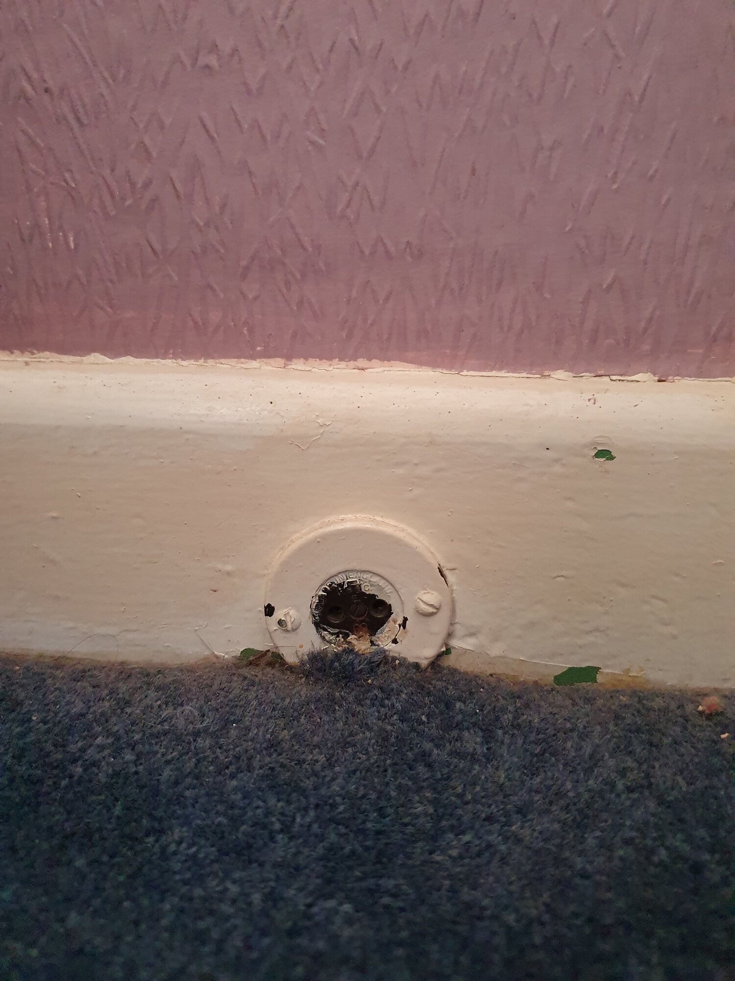

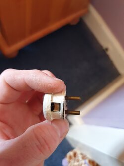

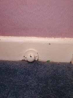

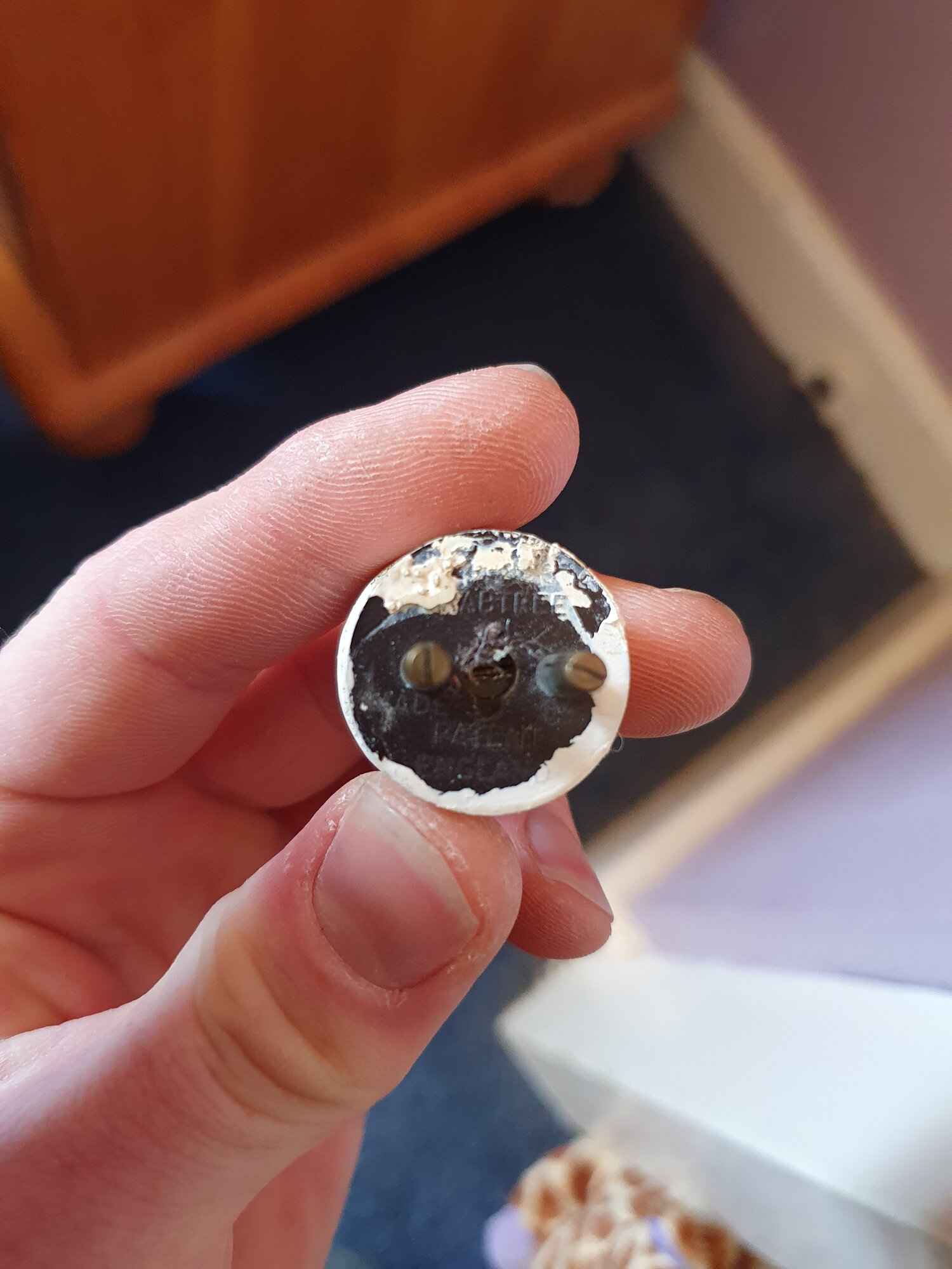

Hi guys
Found this at a house dating from the 30s. No power but just curious as to what it was used. Is that an old socket and that's on old plug top??

Definitely 5A.
The plug (made by Crabtree) was a very common type. The socket (by GEC) not so often seen. It looks like it was rather haphazardly bodged into the skirting board, too near the floor and not level.
Could have been used for anything but typically table lamp / radio / vacuum cleaner. Points for heaters were often near the fireplace and more likely to be 3-pin (although not necessarily) and/or 15A.

At one time there were a lot of electric clocks about. 2A and 5A sockets were often fitted in places where a clock would be used. Such as beside beds, above mantelpieces etc.

More often, dedicated clock connectors that were very shallow to fit behind the clock. Each manufacturer had their own pattern so the plug of one brand would not fit the socket of another, but they were always supplied as a complete pair.
2A sockets, both 2- and 3-pin, were the least common of the sizes in the heyday of round-pin. 5A was the most common, 15A was necessary for heaters, wash boilers etc. But 2A did not have so much of a defined purpose, as many of its applications (radio, clock, lamp) were equally well served by the 5A. It was very compact but had little else to recommend it.
