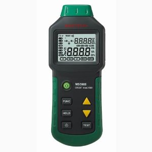

from what recall they use this king of thing:
41wiv7sY33L__SL500_AA300_.jpgand yes...no mention of IR testing here...lolffs..
i guess they use the `bang test`..lol...or just pray the GFCI holds...lol...lol...

Those things are actually quite good, and provide a multitude of tests including GFI testing. Only problem is, very few electricians own one!! lol!!

well...i`v got MFTs/seperates, multimeters, leakage & current clamps, voltage indicators etc coming out of my ears...lol...
nah...i dont think i`d want one of them eng...lol..
i`v got more than enough to cover what that thing is capable of doing...
