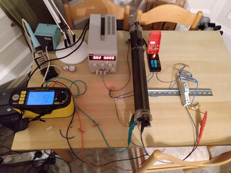

A recent thread was discussing having a delay RCD (type A or AC) for TT before a garage CU with a type B RCD for an EV charger. The question was would this be OK or not? Standard advice is the type B should be direct off supply (possible problem for TT) or fed from another delay type B (at eye-watering expense). But just how sensitive are type A RCD to a small DC component, below the type B trip point, in practice?
So from the department of "don't try this at home girls & boys" I bring you some test results based on this set-up:
Test devices are unused, a year old Hager ADA106U RCBO, and a many years old PowerBreaker H92MPS RCD-FCU. The big potentiometer served to provide a resistance for the current-limited PSU to reliably run at constant current when the RCD was closed, and a path for any mains test current when the RCD opened so it would not be totally forced back through the DC PSU. For testing at home (TN-C-S with RCBOs) I used a simulated TN-C-S test rig so the PSU negative and the MFT earth both go to the pre-RCD mains neutral.
Basically I force DC through the neutral path of the RCD while doing normal MFT tests.
TL;DR Testing RCD to DC effects

The conclusion? Well for the devices tested (both claim to be type A) there is:
  • Negligible change at 100mA of DC (well above a EV's 30mA type B RCD trip current)
  • Some obvious degradation of characteristics at 200mA
  • By 300-400mA they are failing to trip at the 30mA threshold for "additional protection"
Over to the sparkys of this forum for comments!

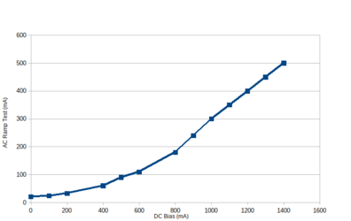

Going beyond the 30mA spec and testing with my MFT set for 100/300/500mA RCD types' ramp tests I got this for the PowerBreaker RCD-FCU (was still on test rig this morning):

That graph is kind of what I would expect, that as long as you fault AC current is enough to drive the differential sense transformer back against the DC bias to get the "30mA" trip threshold in the secondary it will always fire.
So "blinded" is not quite right word, desensitised is more appropriate.

I also did high current ramp-test of the Hager RCBO for comparison, one data point looks out of place, but my MFT was complaining of being too hot by then to re-test!
Results below show less initial problems with the DC (as seen in the tables earlier) for the RCBO but once you get to higher DC bias it is essentially the same sort of slope of ramp-test trip current versus DC bias current as the RCD-FCU showed.
It might also be my MFT only has 50mA step sizes for ramp testing by then and it just falls on the threshold for the outlying point:
