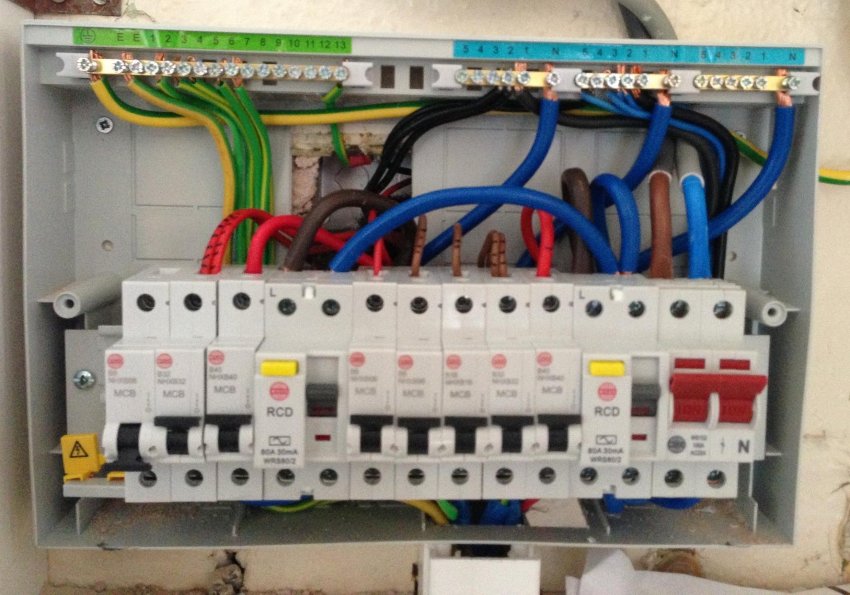

Yea that was it finished lad,:/ is it bad ?
Some (hopefully) constructive critisicsm other than what has already been said....
Why finish your mini trunk 10mm short of the enclosure? - it looks shoddy and technically youre leaving single insulated conductors lacking mechanical protection.
Is that blue tape around the cables where they exit the trunking and enter the CU? If yes why?
Neutrals/cpc's not aligned sequentially on the bus bars
Why only 1 bonding conductor - where is the other(s) connected - if applicable?
Trim down those neutral conductors! - i know they're factory but it looks bad - no need for bare exposed conductor
Invest in some heat shrink and a heat gun
Some of those cables look pretty stretched - nothing wrong with a well constructed joint within an enclosure - you could "hide" it behind the breakers
And as previously posted the IP integrity is dreadful and clean all that sh!t out of the unit!!
sorry if it sounds a bit harsh - i've seen a lot, lot worse tbh....
