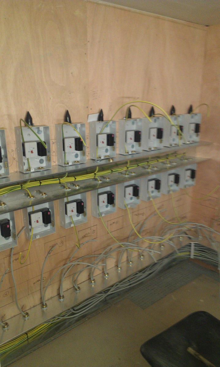

Why what's wrong with it. Looks good
Yes a agree with you but that is what he was asked to do and that is what he has done. So he's made a good job of what he was asked to do.we make install's to allow for alterations and its much better to cut side off tray, file and galve etc then use roofers to bolt together.this is asuming it's not on show because then its usually requested to use pre manufactered bends.that is a much more useful skill to learn

What you've done looks neat. I just cant see any sense in telling anyone to chop holes in tray like that. Collages must be in a parallel universe. One that bears no semblance of reality.
That's because there is no sense in it!! It's more like, yet another collage instructor, that hasn't got a bloody clue about how to design and install tray. Never have and probably now, never will see tray work with gaping big holes chopped out like that, for cables to pass through!!
If i ever saw anything like that on any of my projects, it would be out, ....dammed quicker than it took to go in!!! lol!!

I can just imagine you going at it with a sledge hammer lol!
Why though? It is unorthodox but there's nothing wrong with it and it looks neat. Seems like a lot of fuss over nothing.No, not me, the guy who had installed it would be doing all the ripping out, with me and his boss standing over him, making sure that it did all came out!! lol!!
