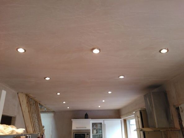

no particular reason... mainly because i don't like it and apart from protecting the cable from said idiots trowel it offers zero protection at all... (plastic capping)
some times depending on chase depth you get a better finish with out the capping having to be covered over as well... them extra few mm can be the difference!!
that kitchen job was a right pain as it initially started as a move stuff about job but then it ended up been full rewire as i found that many JB's in walls i just went sod it!!
Ah right, fair enough then. Throughout my apprenticeship the majority of rewires/kitchen installs i did was for the council and they specified metal Capping so i have used it throughout my career. Its just a habit using it now.
I agree with Durham, capping can be a right pain in the rear and unless it's a muppet of a plasterer not really req'd....do IR test when first fix is finished and take pics of result before plasterer is let loose!

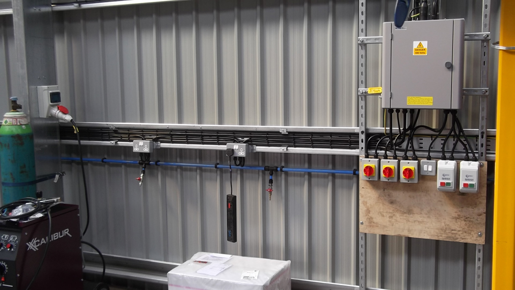

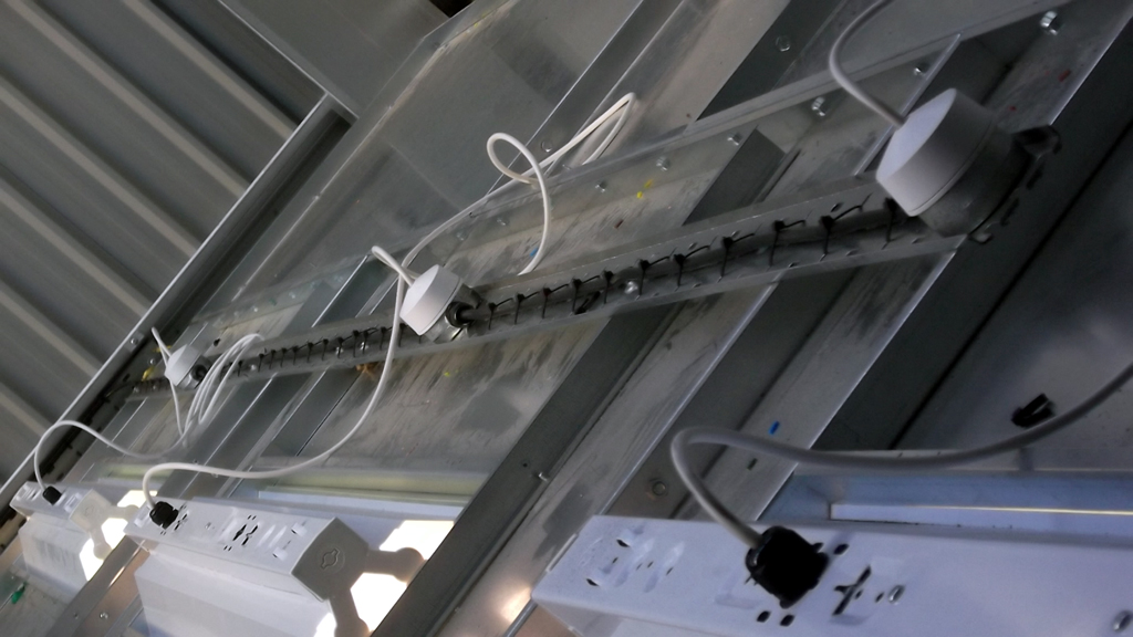

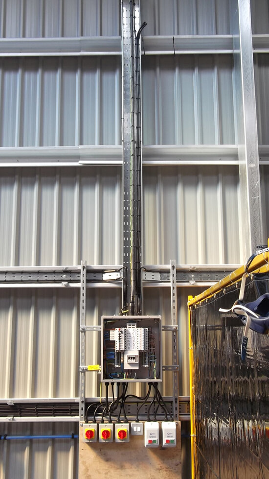

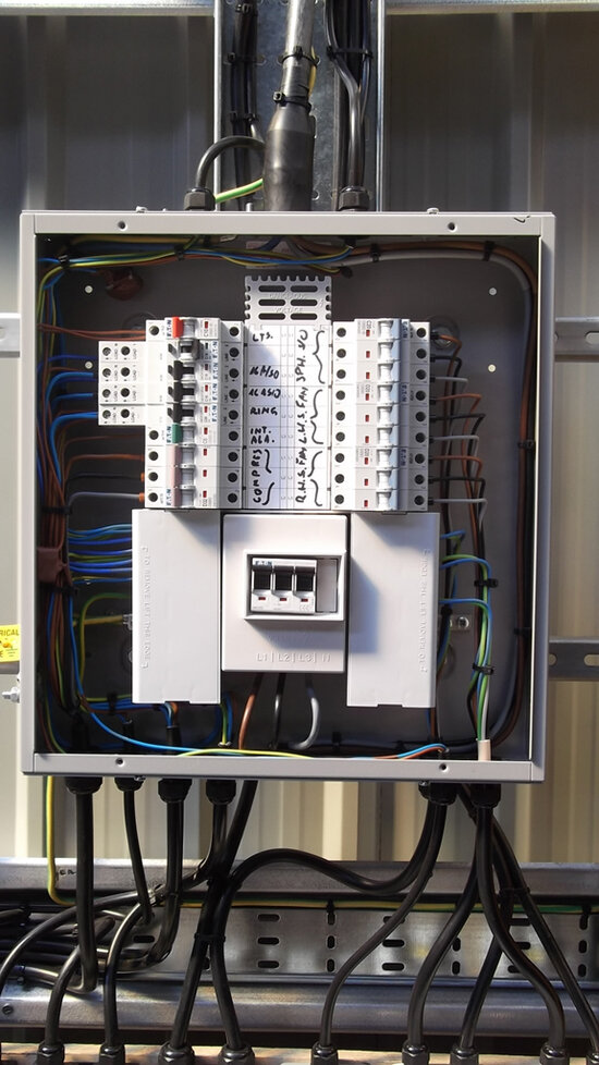

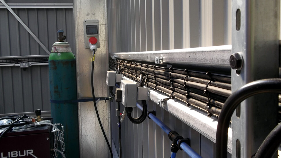

Spay booth project.

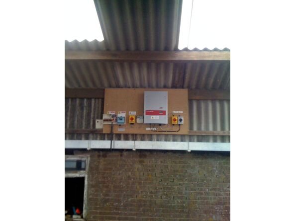

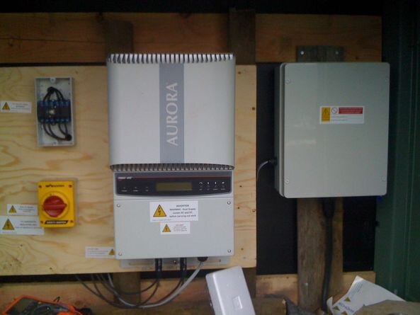

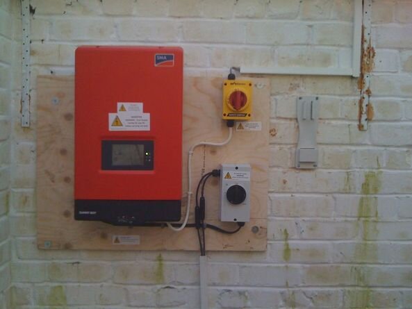

Evening gentlemen,
Just some various solar PV inverter installations that Iv done over the past few months
anyone else got solar pics??
Bob- BM electrics126090183.jpg126090283.jpg126089479.jpg126089513.jpg126089610.jpg

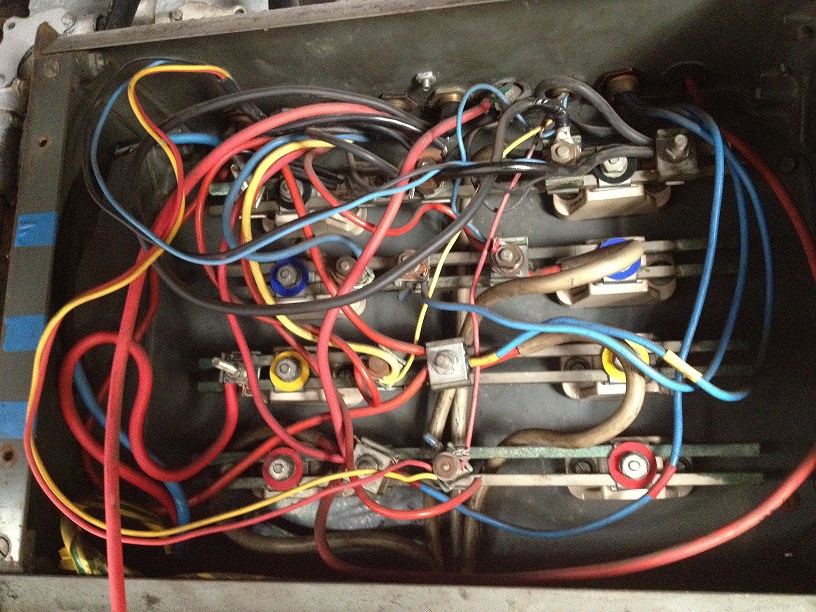

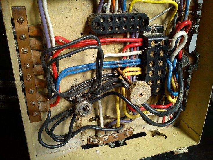

Ever fancied running an Italian restaurant? I’ve seen spaghetti look neater.
All that bus bar chamber is short of is a dollop of bolognaise sauce!
