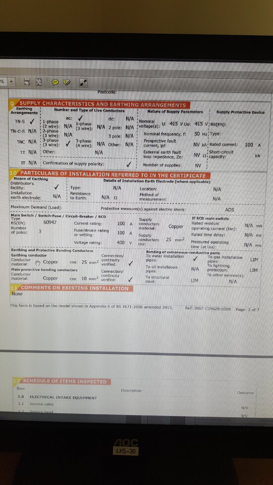

A few points really and it's more due to a lack of understanding on what NICEIC will look for.
They are as followed
How critically will the inspector look at schedule of items inspected and tested?
Ie - Ze is N/V on test sheet, but ticked on schedule as tested.
If I have signed cert would it be ill advised to change the digital cert to change the tick and insert the corrected sheet?
Basically I am not sure if record information that is wrong even if the final readings are complient will be flagged.

These are often commercial jobs, so I understand why the Ze could be a limitation. However the schedule of tests show it as tested (a tick)
These certs were signed before I was taken on, but you could argue that a badly filled cert signed isn't complient. I don't want to alter and counter sign if this will cause more trouble, but equally if not correcting them is worse then I want to know I wont get stung.
Nominal voltage to earth 415 v ,doubtful I would bet.
Plus it's 400 v nowadays isn't it, or that's what we write in.
What about the 3 phase 3 wire? Or the no Ze, but the have confirmed the continuity of the main earthing and protective bonding conductor.
They have listed the supply characteristics but on the tick list it's N/V

Badly filled out certificates are very common unfortunately.
In your case I would say that you are not responsible for work done before you were appointed, however if the NICEIC are assessing a period which pre dates you then they could be unhappy, however their approval is for the future and so long as what you are doing is correct then they should be able to permit continuation.
Modification of finalised paperwork is not a good idea, reissuing the paperwork with the correct results and recording this action would be a better way of proceeding as this maintains a paperwork trail which would normally be needed for quality assurance (ha, ha!)
