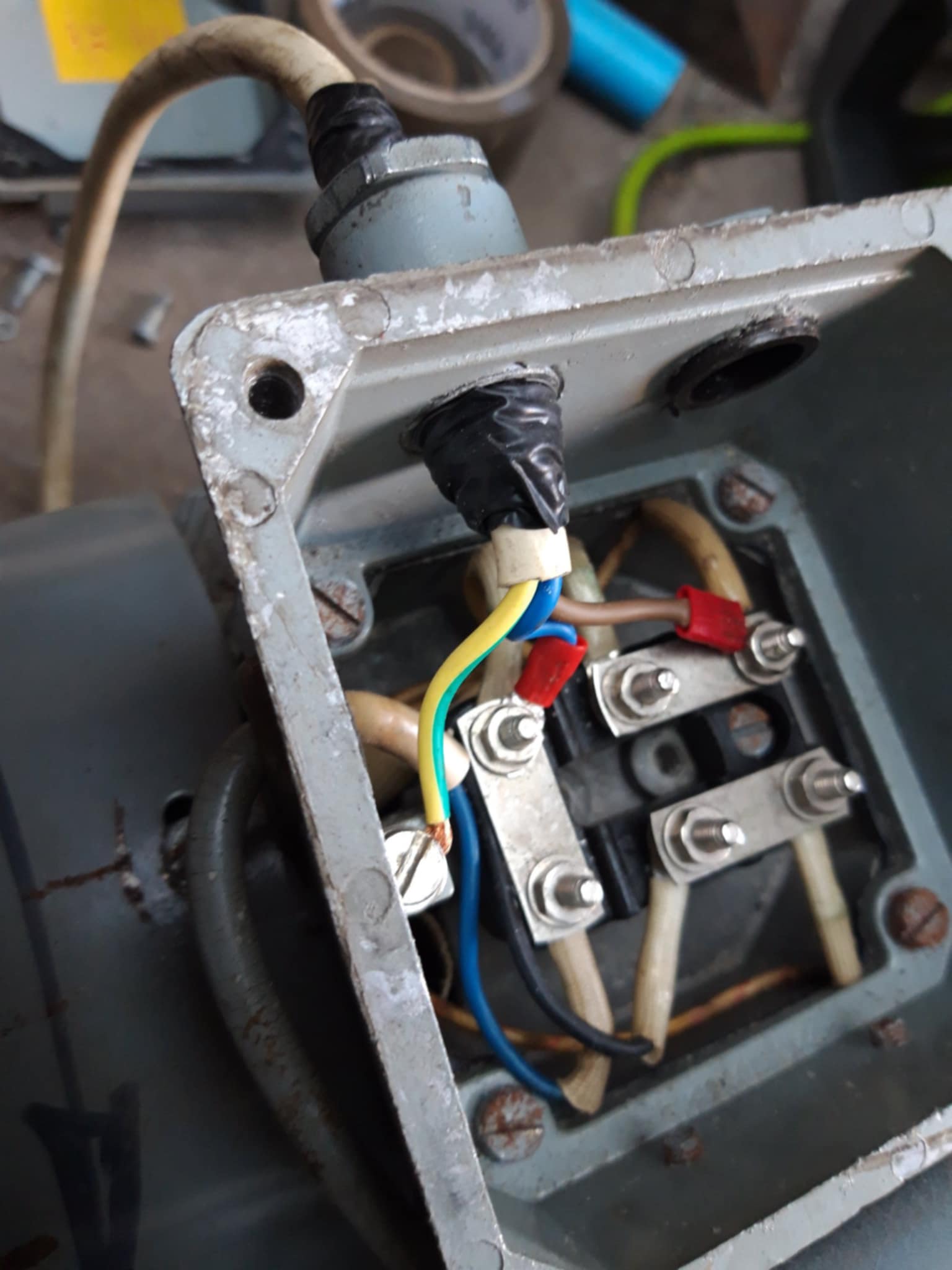

So, a single phase motor I have bought. I have wired it up, as the diagram shows on the motor, and it's tripping the RCD when I turn it on. I have tried it wired up for forward and reverse and trips the RCD on both. I removed the lead that goes from the wall plug socket to the motor and tried that lead with a hair dryer - doesn't trip the RCD. So it must be the motor that is the issue.
I bought it from a guy who said it had been in a container for years - it looked unused since it still had the plastic cap on the shaft.
Here are pics of the motor, the way I wired it etc.

I would insulation test the windings and capacitor
If you don’t have the equipment to do that, put it in a warm dry place for a week with the cover off.
I would replace the capacitor if it has been standing for years, they can dry out and fail with a bang!

I opened up the motor and the windings in the stator were black, has to be burnt out for some reason.
Looks like it has been left powered with the shaft held stationary
Only cooked the windings in 2 opposite positions
Throw it in the scrap bin.
Reactions: Ell181
Told the seller and got a refund. Kept the starter capacitor though - do you think the capacitor might be in bad way as well?
Reactions: James
There's a good chance that a failing capacitor was the root cause of the winding failure.
