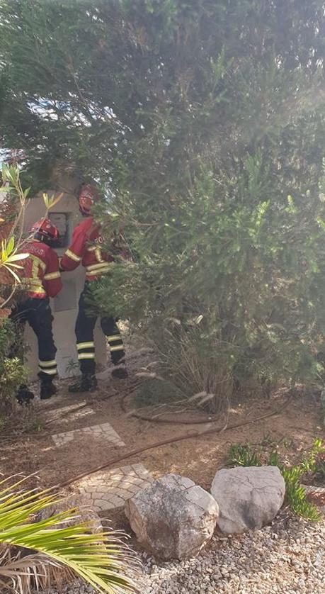

Hi all, a recent call out to a frantic home owner that the most everything in the house had blown up !
The cause was quickly found, the recently fitted smart meter had had a terminal failure at the neutral and as the supply was 3 phase and the overheating terminal got worse the neutral was completely lost and of course 3 phase without a neutral in a house full of 240v equipment has only one end game!with near 400 volts on the sockets and lighting circuit there was a hell of a lot of damage, near €17k worth.
The smouldering meter was attended by the local fire crew and an emergency repair ( was a Sunday ) by the power suppliers cont
contractor was not great, but they did return with a new meter the next day and actually did not fight the compensation claim at all, and paid out in under two week !!
The installation of smart meters here seem to be of varied quality and keeps us busy with faults...

My guess would be on poor termination.
the length of exposed conductor on the other terminals, added to the fact that the cables could easily be dressed nice and neat but were not.
makes it look like a lazy or incompetent installer.
If a trainee presented that as a finished job for me to check, I am not sure if I would be laughing so hard that I could barely speak or if a few choice words about a change of occupation to full time broom operator would be a good career choice.
difficult to tell from the pics, but are some of the top screws bottomed out without trapping the cable/s?
Yes the meter had only been installed 4 days prior to the failure, the cable termination was very poor and with no shadow of doubt the root cause of the failure.
I took a lot of pictures and did a scathing report to the energy supplier and as I mentioned they paid out very quickly, the smart meter install roll out are so far behind target the quality is suffering over speed.
