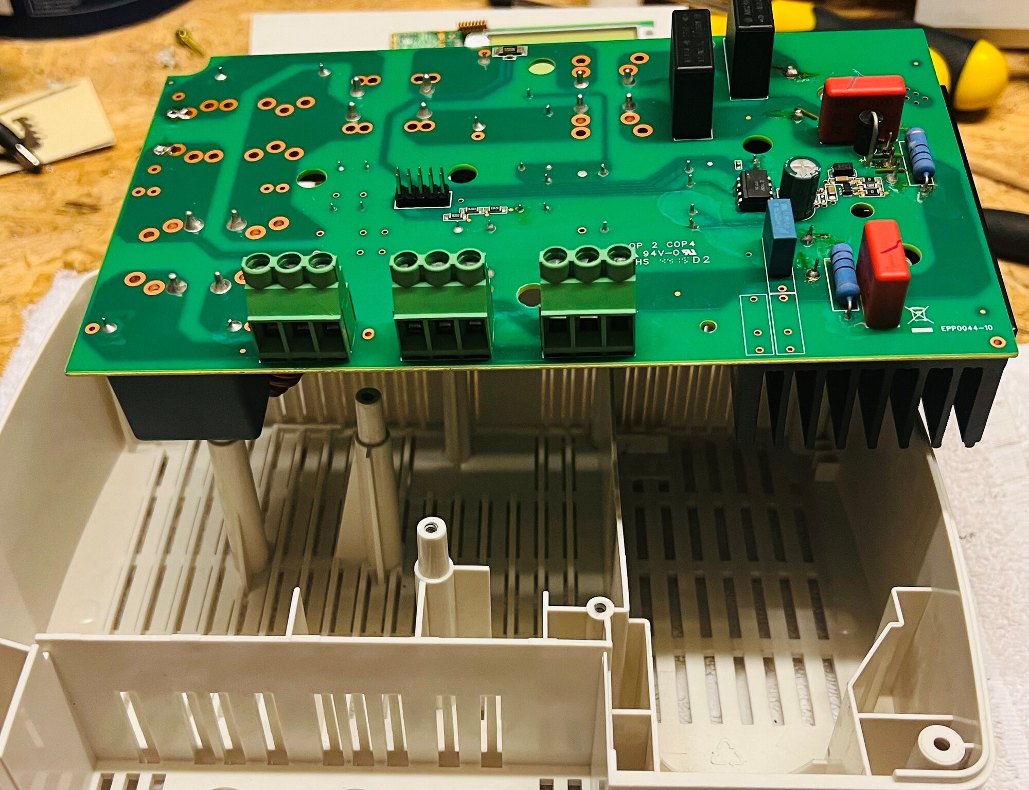

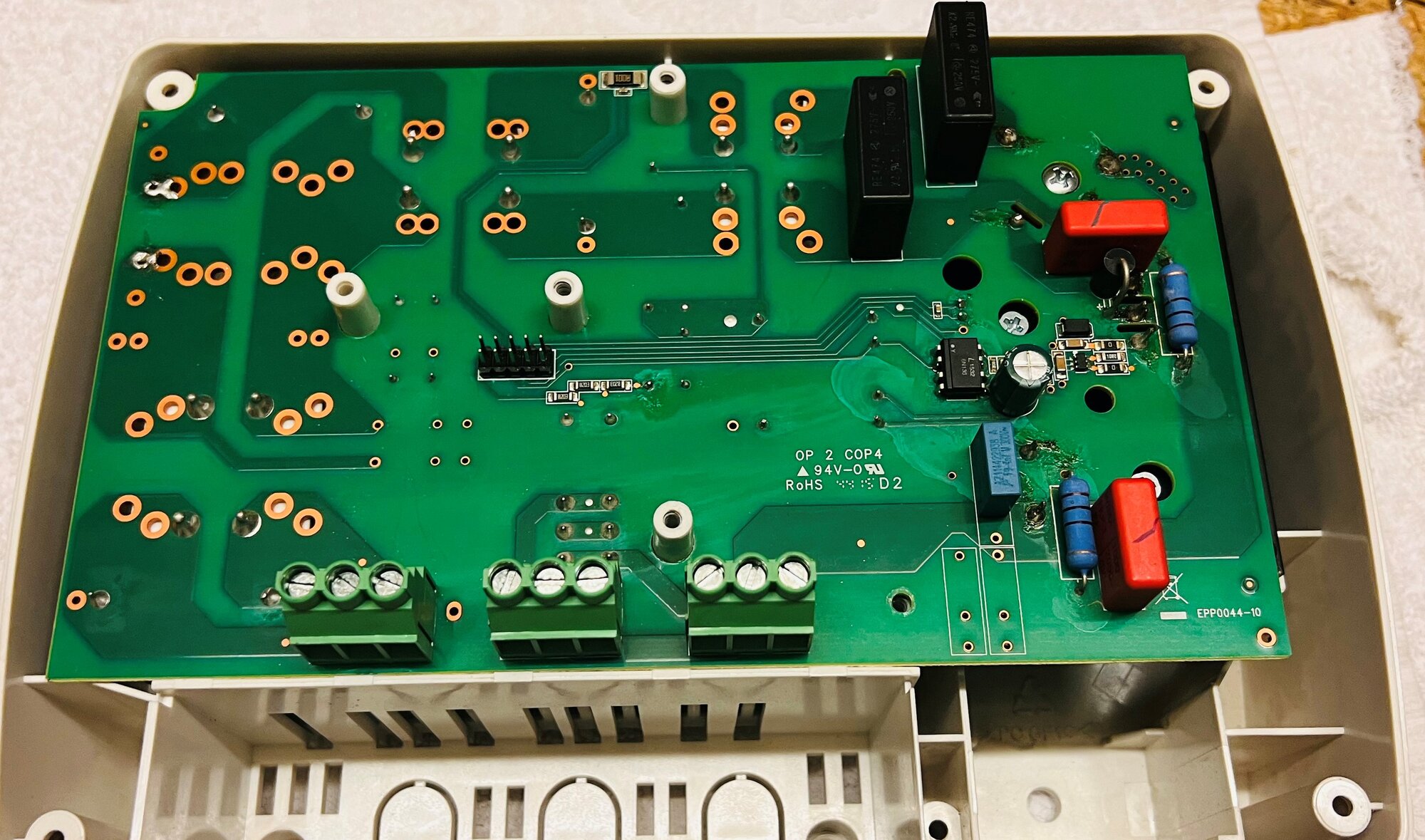

Thanks Mike. Alas, the screw heads are about 5cm into the casing via moulded tubes. They are quite small and may be spline headed but v. diff. to see.
Buy a multi bit screwdriver set. Won't cost much for one that will cover most things. Just make sure it is a long reach set though!
16A to match what was there. I bought a pack of 5 from amazon. They were too big so I soldered it to the top of the fuse holder as there was plenty of room. I think I paid about £5 for the fuses. Make sure they are fast blow as well otherwise if you use standard blow, if it goes again it'll fry the circuitry.
Thanks. Would you mind posting the link to the Amazon fuses in this thread?...it may be too late for me [I think I have fried it now] but others reading will appreciate it. I'll try 'your' fuses as well....I tried a standard 13A fuse at 03:00 this morning after my Much Better Half reported the unit had died....the internal fuse was a right mess..yuk. It popped the fuse immediately. surprise surprise

Don't use a glass fuse as a replacement for a ceramic fuse, they cannot handle the same level of fault current. It will have been designed with a ceramic fuse for a reason.
Holding a fuse in place over a blown one is an extremely silly thing to do, if the fault which caused the fuse to blow originally was still present you could have sustained serious injury,especially if you are using the wrong size/type of fuse.
If you post a picture of the original fuse someone will probably be able to identify it and advise on where to get it.
Don't try replacing it with the wrong tyoe/size/rating as it may do more harm than good and leave you with much bigger repair bill.
I didn't. I replaced a glass fuse with a glass fuse rated identically :) admittedly it was a slightly larger glass fuse but it was rated the same. Admittedly ive done many silly things in my time. To be fair though on this occasion tested all the component's I could first with a multimeter having taken the unit off the wall. I used a phantom power supply to test the led circuit to see if it lit up when I put the fuse in. It did. It wasn't attached to the mains electricity supply. I did fully expect it to blow again when I reattached it to the mains but it didn't. Both it and I survived but I would not advocate anyone else doing it as my level of controlled silliness may not be matched by common sense in others. Thank you for your concern though :)
Wow…your original fuse was a glass one!
I didn’t see that coming😳
I’ve ordered a pack of fast blow 16A ceramics…. this will be interesting🤔

That’s good information. Any chance of pictures to show where the fuse is you have replaced.
im in process of getting solar iboost. It’s a need to know thing.
Not from me I'm afraid. It's inside the unit... its one of those " open here to void the warranty" things. Mine was out of warranty anyway. If you open the unit the fuse is pretty obvious but it's not supposed to be "tampered" with so be aware.
