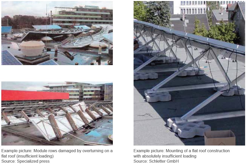

You really need calcs. it not just about ground pressure, think what would happen if (from Mark C's photo) the hedge behind it was removed and a 50 mph wind came form that direction. you've potentially got an awefully big kite. So you need to take overturning moments from wind pressure into account also.

These photo's taken from Schletter's guide on flat roof mounting (general_hints_on_flat_roof_mounting_I400112GB.pdf) the same principles apply to ground mount, get the calcs wrong and wind loading can destroy the array:
Scary stuff but just one look at the ballast weights and you can see that they are willfully inadequate.
Obviously we all know wind sheer is a concern and any design must incorporate measures to ensure the array stays put. Wind sheer is a lesser concern with ground mount over roof systems due to the likely hood of air disruption at ground level due to buildings, trees etc and the lower altitude.
