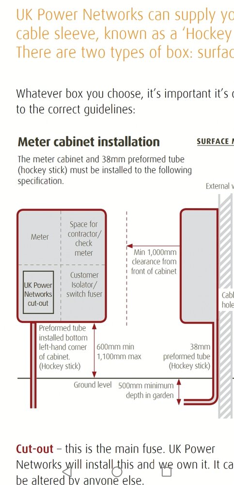

The bottom right quarter of a meter box is reserved for customers equipment. The DNO do not own the meter box, the customer does.

Correct. But the supply agreement normally stipulates that the meter box is for the exclusive use of the DNO and meter operative, just the same as they always have a separate board from the consumer unit if the point of supply is inside the house.
Ownership of the meter box basically means that the customer is responsible for maintaining it.
In theory
Source URL: Supply to garage. - https://www.electriciansforums.net/threads/supply-to-garage.188535/#post-1643781
In theory

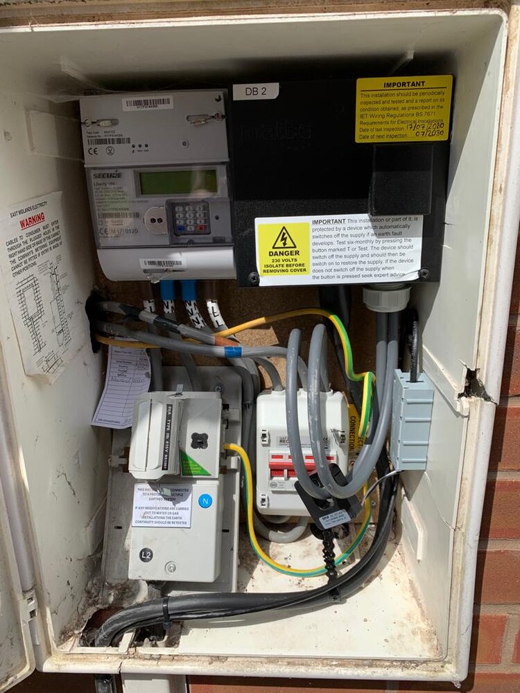

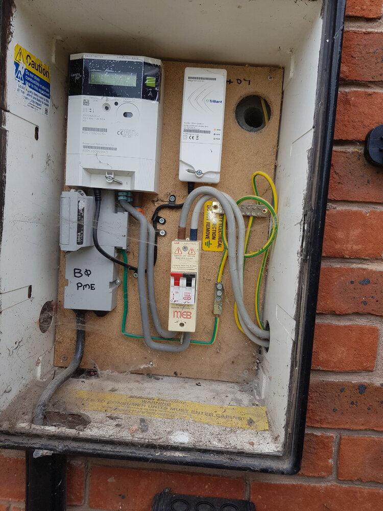

I see an awful lot of consumer units in meter boxes. They never complain
I have been to many meter boxes , and they are jammed pack with PV equipment , isolators, switchfuse, and even seen CU's in them.(thats without the cutout)
Smart meters with comms hub and T2 Aerial if needed take up a lot of room, it would not fit with the mentioned equipment above.
It is the space for DNO and metering equipment.
