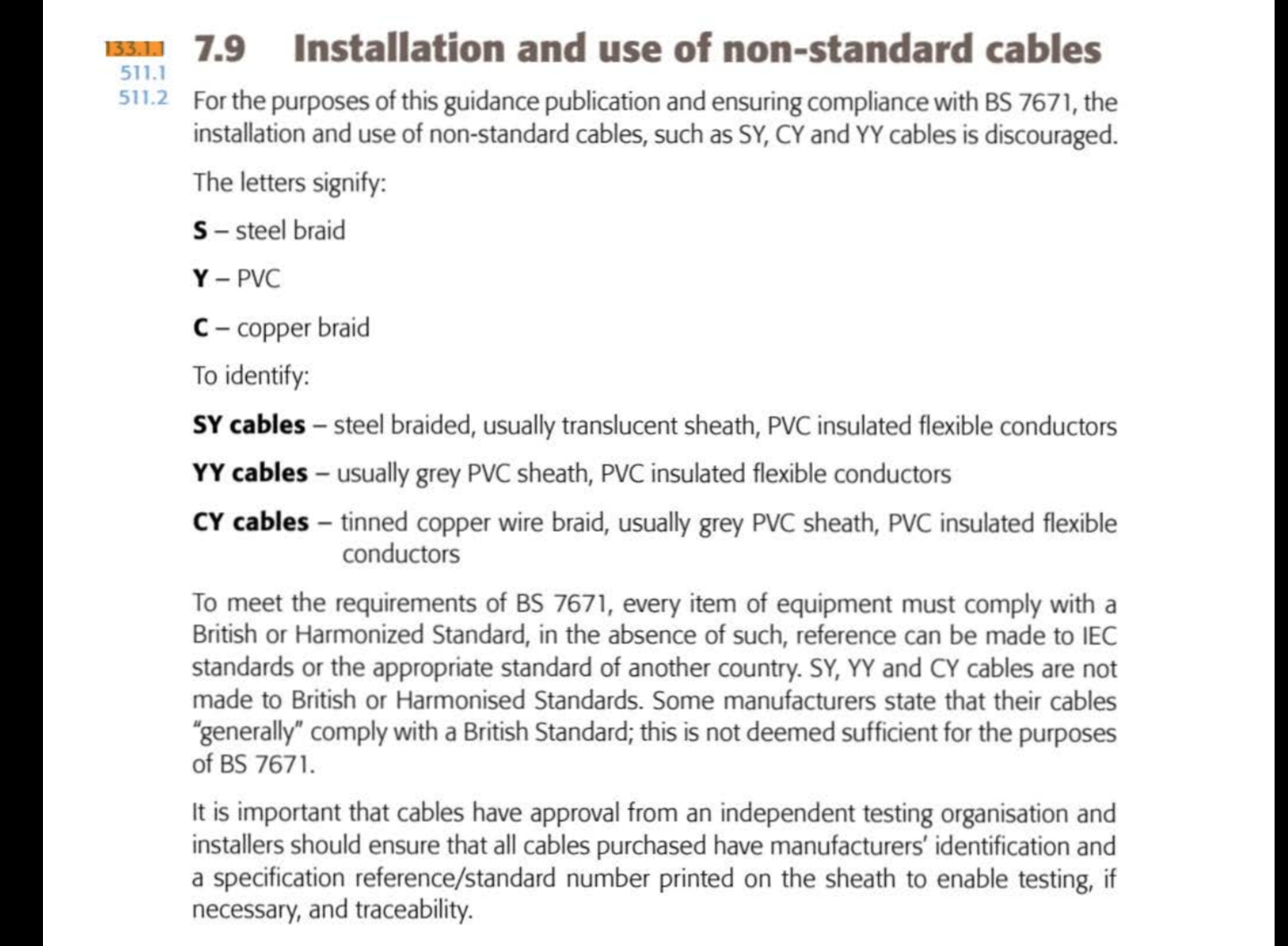

We have an event on tomorrow and we been asked to run 100m of 4mm sy cable to power up the event.
Now I know have mixed options but can this be done or should it be run in SWA cable??
The cable will be protected by 32amp in a splitter box
Cheers guys
Well 4mm is 11mV per A per m. I’ll let you multiply it out :) .
Depending on actual loading I think you’re going to need 10mm or more. Why not use SWA?
It will either be SWA or Hi Tuff. And 4mm will not be sufficient, even with diversity you will be looking at a minimum of 16mm.
100m is a long distance.
How will the cable be run for this event?
How are you protecting it?
Cheers
They think sy is totally acceptable and say it an be used in running three phase power,
Cheers guys for feedback.
How do 'they' intend to run this cable?
How are 'they' going to protect it from damage?
