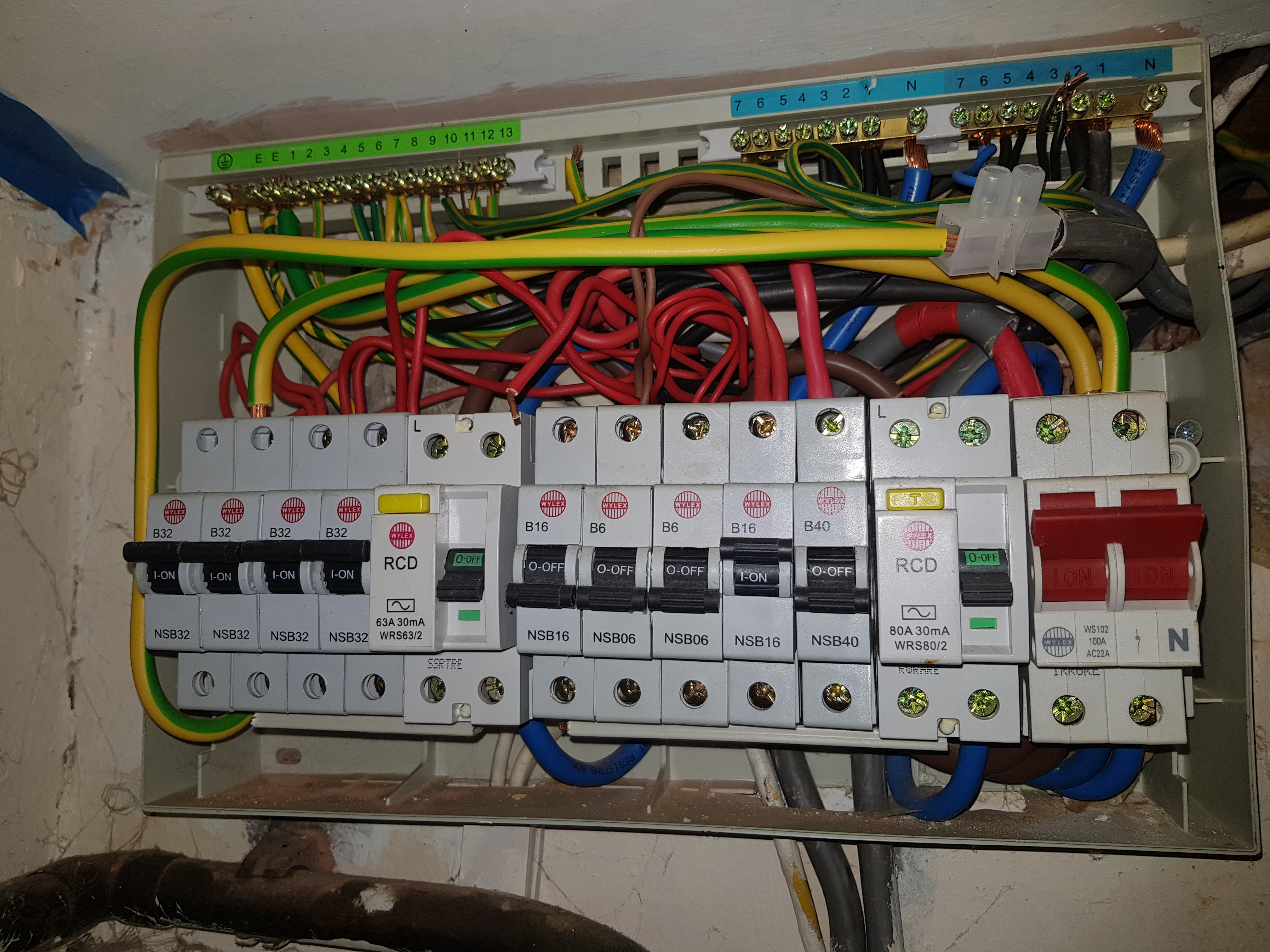

Had to do an EICR on this property, noticed a shed load of overheated Halogens on walking in...
Then I removed the board cover!!
It looks like they've taken the neutral through a 32a mcb using g/y for some reason, I can't see where the yellow cable goes.
Do you know when this was done?
I believe the yellow cable is actually green/yellow (with just the yellow stripe on show) and it appears to go to the earthing bar :)
Also...
The kitchen had two ring final circuits, one of them was purely for the fridge. I think the last muppets to do electrics only knew that circuit type. Lol
Overall the other circuits were fine apart from lighting with Downlights, they cut earth out at each downlight :/
