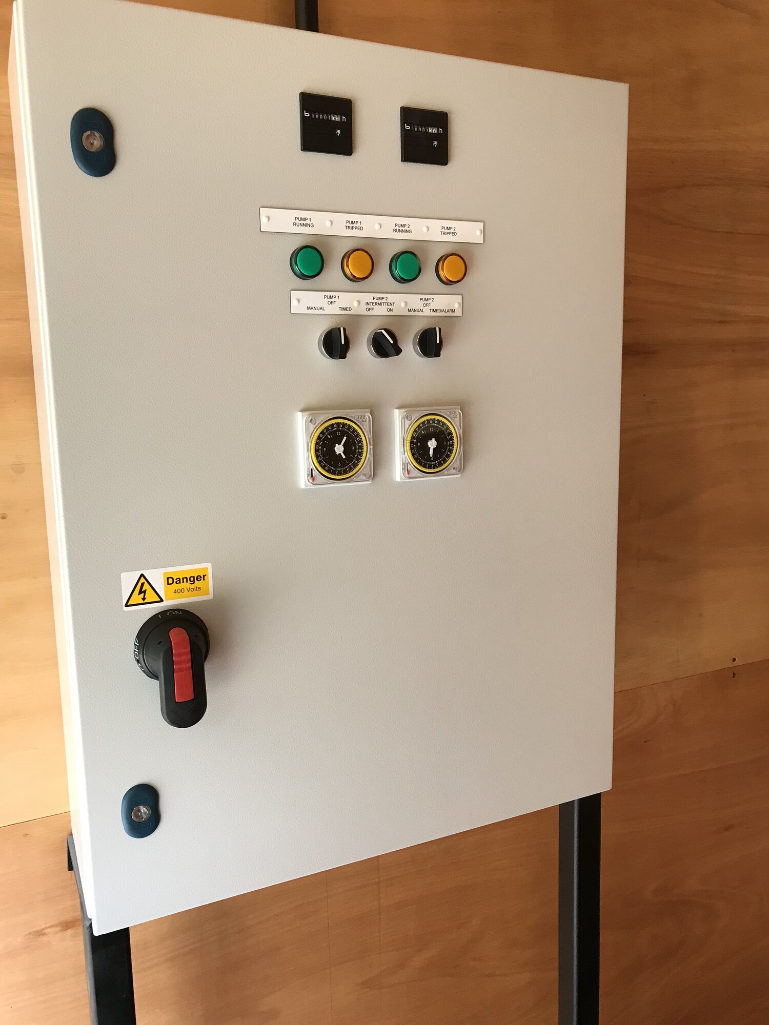

I have a new TP pump install, the supply comes from a 80 amp switched fuse disconnector from the road straight from the supply tales via a 5 core 35mm. Into a specially built housing within which a controller with inbuilt isolator is situated. I was going to install a separate triple pole isolator before it went into this control kit.
But I don’t think it is necessary as the pump control gear has an inbuilt isolator for the entire panel. If i did install i would only be isolating 2 feet of cable between the incoming armoured and the pump control isolation into the box. Bad boy or reasonably and practicable boy?
