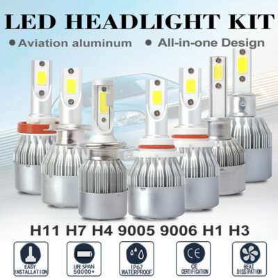

i replaced mine with LEDs. brighter and trouble free.
Just looking on eBay now as I will need to get at least one pair for the farm ute.
be careful with ebay. a otof the H4 LEDs say they fir, but you can only ever get either the hi or low to work but not both. i'll try and send you a link to the ones I bought. they,ve been in service for 2 years.
wattages quoted on ebay are misleading as the actual cunsumption of LEDs is lower than halogens. the link i sent says 200watts, but that is probably the halogen equivalent. 200 watts (actual) would blow your fuses.
