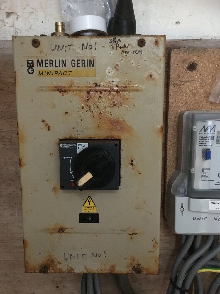

Father in laws project. He’s bought a massive shed to store our caravans in and I’m bringing the electrics up to decent condition. (30 odd double sockets and a couple of 16A commandos on one rfc!)
so.... can anyone tell me what size this breaker is? I’m guessing 63A. It fed a 32A 3ph socket at the far end.

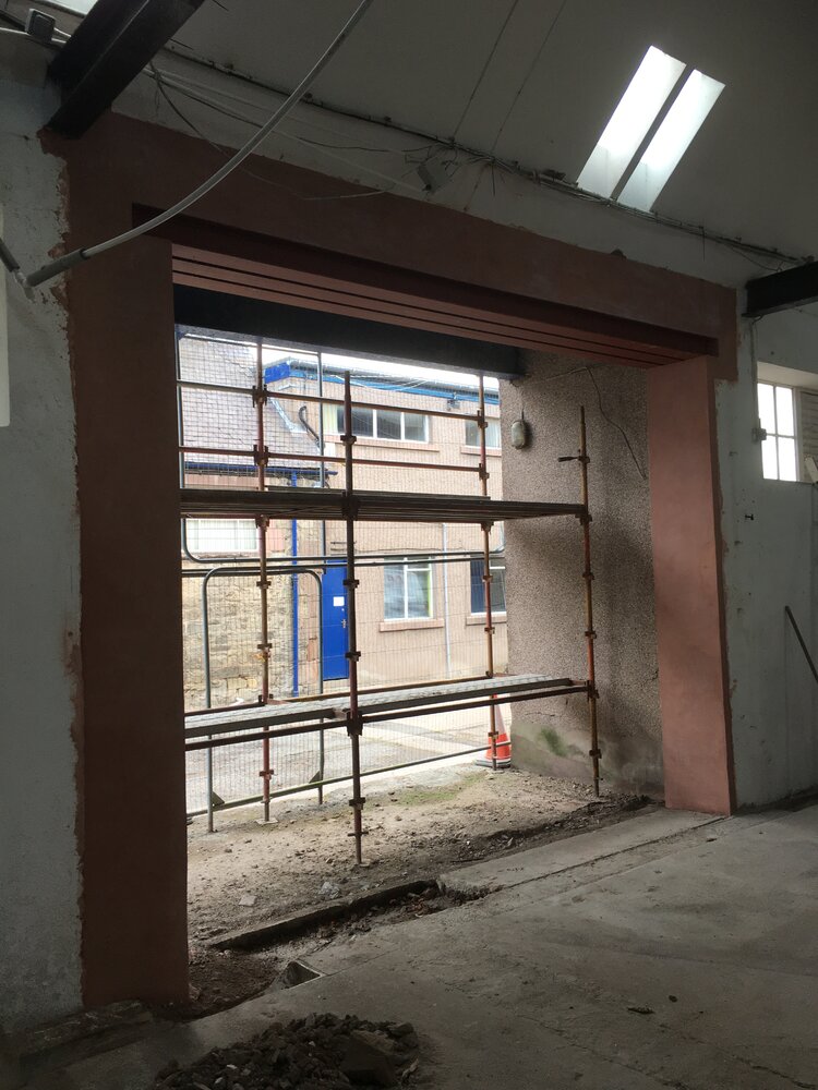

we’ve had a door widened to get the caravans in and out. It’s getting an electric roller door fitted, but I can’t get a hold of the installer to find out size of motor. Guessing it’s either 16 or 32A supply the need. (Single phase. Not getting used much) The opening is 12ft high and 18ft wise.
Anyone with experience of these doors? Or shall I just put in a 32A supply? Can always downgrade OCPD later.

Hard to tell the rating of the MG, you'd probably have to take the cover off to confirm.
Most single phase doors can be run from a fused spur or a 16 amp radial would normally suffice.

Minipact was available in 16A - 63A so you will have to check the actual device - similar enclosure for many sizes.
As for motor size, I have come across loads of variation - it depends on material steel/aluminium and thickness - high security ones can be very heavy - these tend to be 3 phase though.
I would put the largest size feed in you can until you get the correct figures

Regarding the MG Breaker I would consider changing it for new so the size would be upto your future requirements and governed by the incoming supply

Didn’t have my tools today, so didn’t take the cover off the MG.
there’s 25mm tails feeding this, and a 16mm twin and earth coming out to feed the existing single phase db.
Out the top is a 4 core 10mm I think.... doesn’t say on the sheath... that fed a 32A socket at the far end. I’ve previously rerouted this cable to where the kitchen is going to be, so all final circuits will come from a more central position.
I’m thinking a 16A would suffice for the roller door. It’s not a huge door really.

The MG is 32A...... there was a sticker on the top that would have been visible if I’d given it a wipe.

I put in a 16A supply with rotary isolator for the roller door. It was installed yesterday and it came with a 13A plug top fitted!
Also comes with remote control key fobs so can open it from outside. No need for extra wired key buttons or anything.
