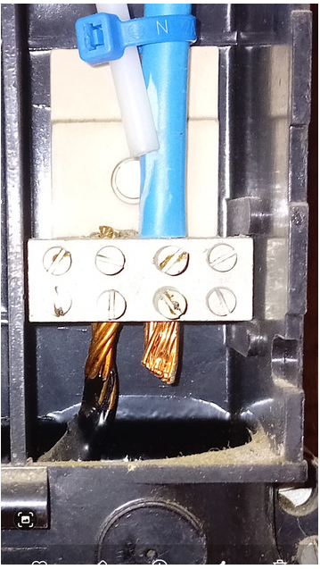

My house was built in the 1930s, The fuse in my service cut out is 60Amp and the wire coming from the street has a 16mm2 copper core(easy to see against the 25mm2 copper tails into the smart meter)
I am ready to install a new 10.8kW Shower, Is a simple fuse change sufficient?
Ive been told by an electrician that the 16mm2 cable coming from the street should be 25mm2 to support a 100A fuse.

Either you or your electrician need to contact your dno to ask about increasing the supply fuse, neither of you are allowed to make this change, only your dno can. In my area you will only get an 80A max and that is if local network demand allows this. Whilst under our regs 16mm tails shouldn't be used for 100A supplies the dnos work to different regs and it is up to the Network Planner to determine whether the cable is sufficiently sized for the demand.

This is my service.

In other words, that part of the electrical installation should not be accessed by untrained personnel… not even your electrician.
It is dangerous to uncover live parts such as this, as well as an offence.

Your electrician isn’t taking diversity into account… that’s where your total load of over 100A won’t take anything near that at any given moment.
Your 60A will be fine, but the DNO could increase to 80 if asked.
What’s the lack of ferrule crimps got to do with it?
That cut out should have never have been opened… and usually, it can’t be without the main fuse being drawn.

its a cover only, with nothing inside attached.
when you say dno could increase to 80, is that via fuse change?
I'm not sure where this thread is going or what you are demonstrating is by an electrician or yourself. It doesn't really matter as the forum cannot condone what has been undertaken, it is dangerous and as such this thread is closed.
Seek the advice of your service provider.
