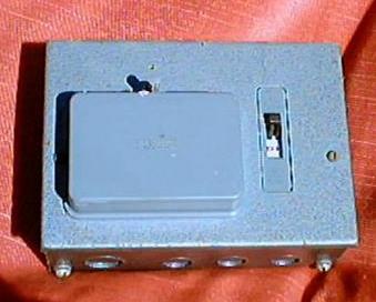

I'm looking for 2 x Wylex 4-way fuse covers in dark grey.
I've searched the Internet in the hope of finding some, but haven't had any joy. If anyone has any of these covers going spare, please get in touch. I'll cover your postage costs and make a donation to your drinking fund.

An EICR was recently done on the property and the inspector gave the item a C2 code stating: "Enclosure not damaged/deteriorated so as to impair safety (621.2(iii)) is in a potentially dangerous condition" - replacement fuse cover required.
The owner will be letting the property in the next few weeks or so, and has hired me to carry-out remedial work. He asked me to see if I could find a replacement cover. I told him I would look, but that I wasn't hopeful of finding one. He's concerned that a curious child might poke a finger through the gap around the fuses and the front cover.
The C2 is unwarranted. The front, even with the cover missing, is IP2X which is the current standard of IP protection for the fronts of enclosures against live parts.
Is that the only issue that needs addressing to make this EICR satisfactory ?
Is there RCD protection for socket outlets and bathroom locations ?
^^ missing the removable cover off that style of fuse board - a C2????????? not for me unless little fingers can get at the live copper inside...
I agree with you both. I did try to explain to the property owner that a C2 code was, in my opinion, rather over zealous, and that there is no real cause for concern here. I will try again to reassure him.
The remedial works required are: main bonding to the water inlet, RCD protection for the shower, bathroom heater and lighting circuits, IP-rated ceiling fitting in bathroom, labelling of circuits, and a couple of disused entry holes in consumer unit to be blanked-off.
^^ maybe suggest a new fuseboard........ and surely the sockets need RCD protection too!
I did make that very suggestion right at the start, but he declined.
There is no RCD protection for the sockets, but since the property is a top-floor flat in a four-storey block with there being little probability of any of the sockets being used to supply outdoor equipment, the C3 code on the EICR was the correct call. I've yet to meet a landlord who acted on a C3 advisory. Almost all of the ones I've dealt with appear to interpret C3 codes as: "Oh good ..... I don't have to have this done and can save some money."
