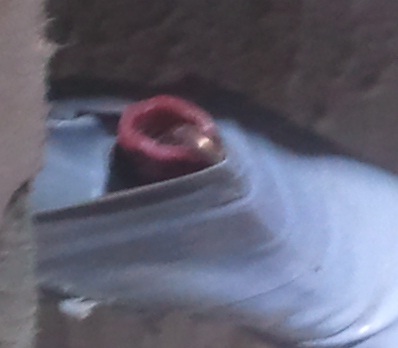

Just a word of caution why you should never pull energized cables around.
The crimp you can see is the line conductor - found this done by a kitchen fitter who had fitted the lady's kitchen 2 years ago to extend the ring... the opening must have originally contained a socket outlet that the guy removed and he shoved this bodge to the side, (the opening is not covered with a blanking plate) it is located under a worktop behind a dishwasher so is out of sight normally..
This was meant to be a simple job but I found almost everything the guy did of poor workmanship or none compliant, not a single grommet used, not a single back box fly lead, spurs off spurs, as you can imagine the lady never received a EIC... The not so funny thing is he told her he was giving up the install game to go and teach electrics at a college....

That don't look to good but without sounding rough , didn't think grommits were required by regs, just good practice, and fly leads are not required if there is a fixed lug on the back box
Yep rough is the word, I did write poor workmanship or none compliant, none of the back boxes had lugs, I could have listed everything but it would have been a big post...
I just wanted to warn people there are non safe installations are definitely out there...
