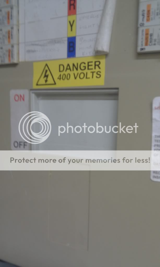

Came across this today, do you think it needs a code 1? (I wasn't doing a PIR btw)

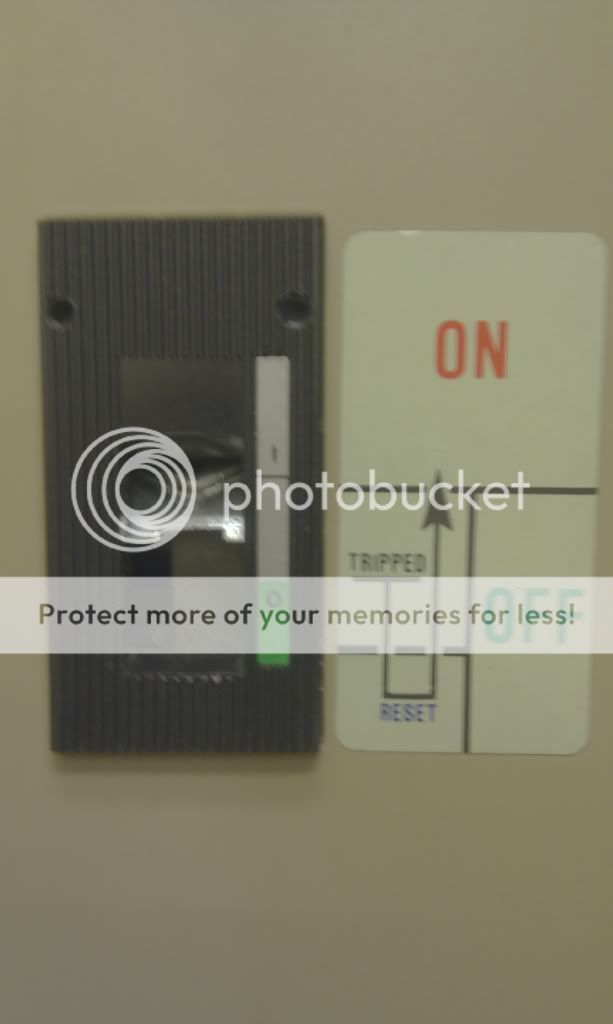

The main isolation switch is broken off in the closed position with metal showing and your able to put objects through the hole (can't really see on the pic)

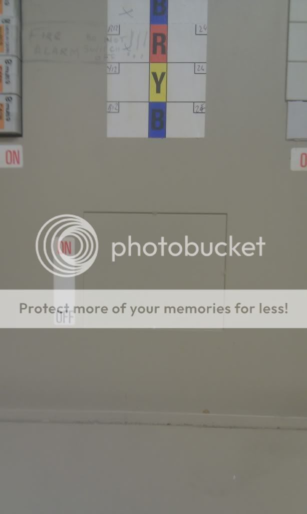

Db 1
Db 2

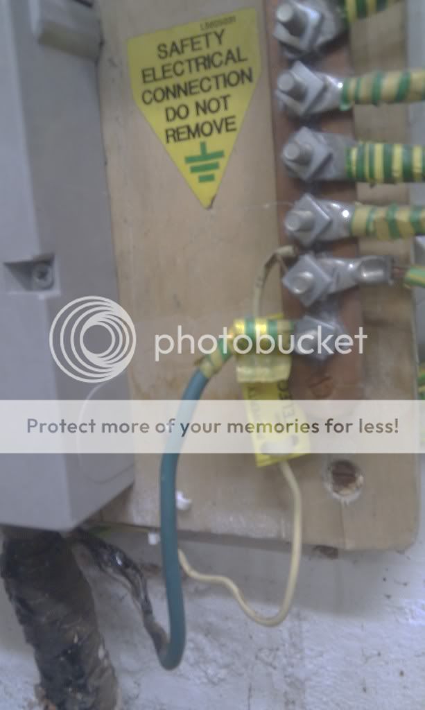

Do you think the main earth needs replacing and up grading?
The warning notice above should read "electrical connection do not remove because it will burn out by itself in due course".

lol whats he want some tape over it so as to reinstate barrier to ip2x and is that a new form of UPS
Yep there's no way to isolate any of the db's. It's been like this for years and they won't put their hand in their pocket to sort it out! "where's there blame there's a claim" springs to mind, just a matter of time.
F me it gets worst. Gone back this morning to finish off and rain is getting into the electrics cupboard and falling on top of the dis boards. I told the manager and walked away until its sorted.

code1 for the broken switch and letter via registered mail to inform him of your concernes better writen down than "I told you!" verbal could be denighed and registered mail proves you did everything practical to imforn him of the dangers oooo and keep a copy
