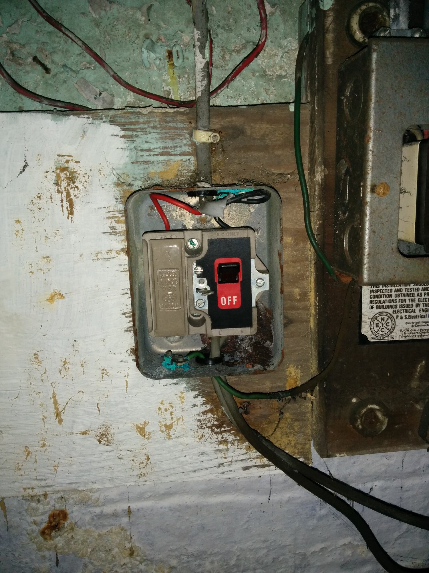

Just went to isolate some kind of antique shower pump thingy in a bathroom for a plumber mate but the switch to it in the bathroom was painted over several times so I couldn't get my voltage tester with probes on it. So I used my non touch volt pen on the switch and the cable going into the switch which showed 230v power.
I isolated what I suspected was the power supply in the basement - an old wylex isolator. Tested the bathroom switch again with my volt pen and 0 volts - Fair enough. That would suggest the isolator was the right call.
Thing is though, When I tried my volt pen at the cable at the isolator (as a whole and also each individual conductor in the isolator) I got no voltage displaying on my pen - with the isolator energised or not. I checked the fuse in the isolator which is fine.
I retried my voltage pen on the switch in the bathroom with the isolator energised / not energised, with the same results.
SO, why am getting a reading with my voltage pen from the bathroom switch and cable at the bathroom switch, but not getting a reading at the isolator outgoing cable??
I'm going to have to return when I have more time to smash open the switch and do more substantial tests cos I like this plumber but I'm still at a loss on why this be...

I may not have fully understood because I've had a few beers, but cross polarity at source?
They do not work with any sort of shielded cable such as FP200, SWA, MICC etc.
They are best used with these types of cables at the very ends where the outer insulation has been stripped off
You might get one to work on a FCU from the outside by the fuse holder for example or even the outside of a socket but if the accessory has been painted then it's another layer for it to go through (or not)
Voltage pens should never be relied on at all and especially to test for dead
Surely
Surely I'd still have got a reading from the cable though even with reverse polarity. Point is I was getting a reading at the terminal but not the source. I need a beer now lol.

So that visible red wire in the fused switch was not activating a voltage pen? As much as I agree that they are hit and miss, and vary in detection quality, I'm a bit surprised.
I'd remove the fuse and fuse carrier and use a 2-pole on it to be sure it's actually energised.
Other than that you have had indication of voltage present and no voltage present in the bathroom. While it seems highly likely you have correctly found the right isolator I wouldn't base the entire conclusion on tests from a non contact tester.

That's just it. I'm surprised also. the tails going into the isolator were lighting up my pen no problem. It's just the cable coming out that doesn't and I can't understand why.
The switch in the bathroom was "sealed" permanently off by paint so I will have to break the switch open with a hammer (which I've left at another job 😳) to test it properly.
It was a last minute job which I was hoping to quickly do in passing at 5pm as a favour cos I'm booked up but didn't want to start construction work at that time of the evening. I will have to go back to ensure it's deenergised I know but just don't understand why I wasn't getting a reading coming out of the isolator. Especially as I was getting readings from the tails going in
What is that between the fuse & switch sticking out? Is it some sort of fail-safe which isolates when cover removed?
When you go back can you remove fuse/cover to expose terminals? I'm sure the problem is probably obvious but you just cannot see it in current state
mechanical interlock. cannot flick the switch on unless cover is in place.... or you push it in with your finger
It's a Memspan switchfuse, they were very popular in the 50s & 60s. IIRC Memspan was the metal version and Memspel was the all-insulated one. Or was it the other way round? As above the switch is interlocked with the cover. The slot in the cover for the switch lever is narrower towards the on position which prevents the user removing it with the switch on. Then, once the cover is off, the interlock plunger springs out and should prevent the switch being turned on unless it is manually held in.
