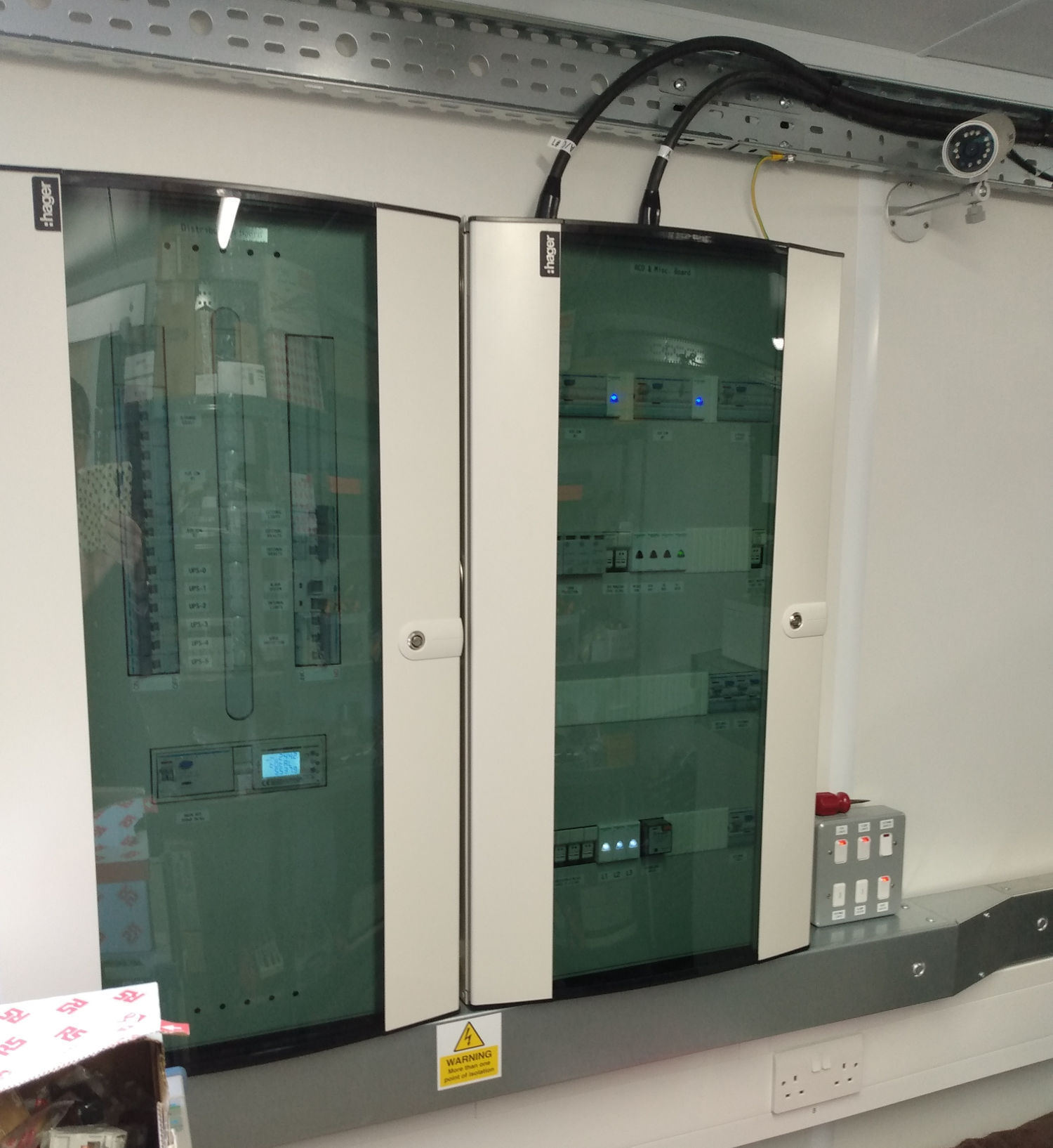

I went with Hager as they do the same, though in my case I mounted the DIN box side by side as too tall otherwise. Main reason for Hager in my case is I wanted the transparent door versions for an industrial application so folks could see the meter & indicator lights, and check nothing had tripped, without having to open anything. Also allows a CCTV remote check of the same!
In true Blue Peter style, here is one I prepared earlier and the blue indictors on the DIN rail board at the top show power to the two A/C units:
Like the camera, "whose be fiddling in here then?"
In reality it is looking at the door in the far corner, but serves as a "did you monkey with it?" record as well :)
So far it has been more of the occasional "Doh, I left the lights on!" check after locking up the site, and the resulting trip next day to put them off.

It sits there as the doors need a screwdriver to open then and it saves going looking for one! Also just out of sight there is a screw in the wall to hand the emergency light test switch and the door keys to the boxes outside for accessing the incoming supply SWA and the (as yet unused) generator terminals.
We are luck that really all staff are "electrically competent", at lest to the point of knowing when not to monkey with something, so locking up it more for neatness and occasional guest loitering than to really keep the usual suspects out.
