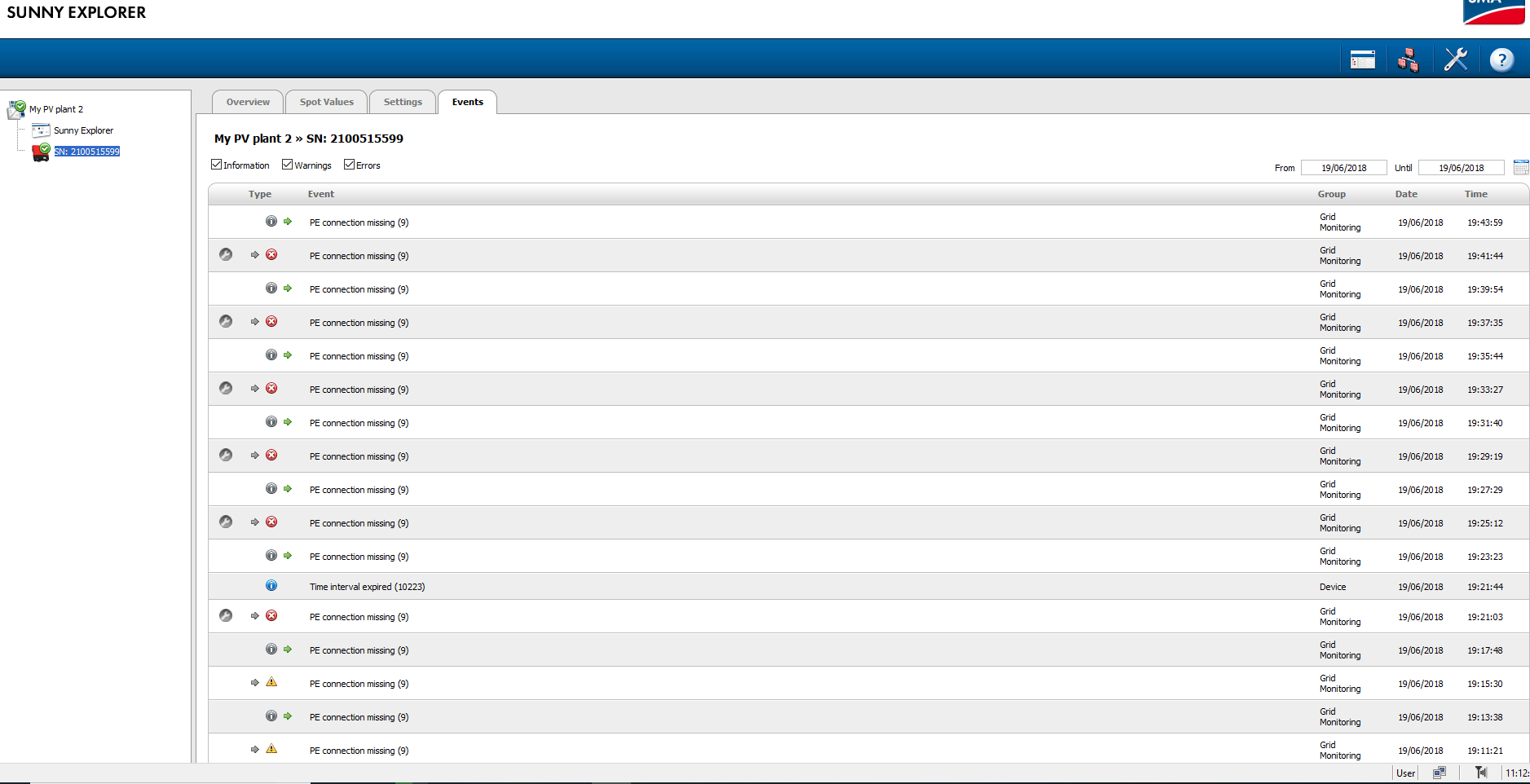

I have had a solar PV system for 7 years now and the 4kw Sunny Boy 4000Tl-200 inverter is coming up with errors. My SunnyBeam logger is showing the inverter cutting out whenever it goes above 2kw on a sunny day. I got an electrician out who says that my Inverter needs replacing however as my MCS is only registered at Declared Net Capacity of 3.68 that he can only install an inverter of 3.6Kw. My original installer - Hatch Solar has now gone bust so I can't ask them why it was registered at 3.68. Can anyone explain what has gone on and whether the original installer was wrong or whether my new electrician is wrong.

4kw was probably the advertised figure where as in reality it only produces 3.6KW. It’s a bit like a car that’s 1100cc but advertised as a 1.2L.
Get a second opinion, and ask for more details of what errors are being logged - you, or whoever comes out to you will need to log onto the inverter to read the fault log.
I'd bet the inverter is fine.

The previous two answers appear to be have been addressed to a different question - the inverter is ceasing production at a specific output.
It may be seeing localised excessive grid voltage, possibly due to inadequate cable sizing, or local uptake in PV is causing a wider area gridgvoltage rise.

I am getting PE connection missing (9) every few minutes.
